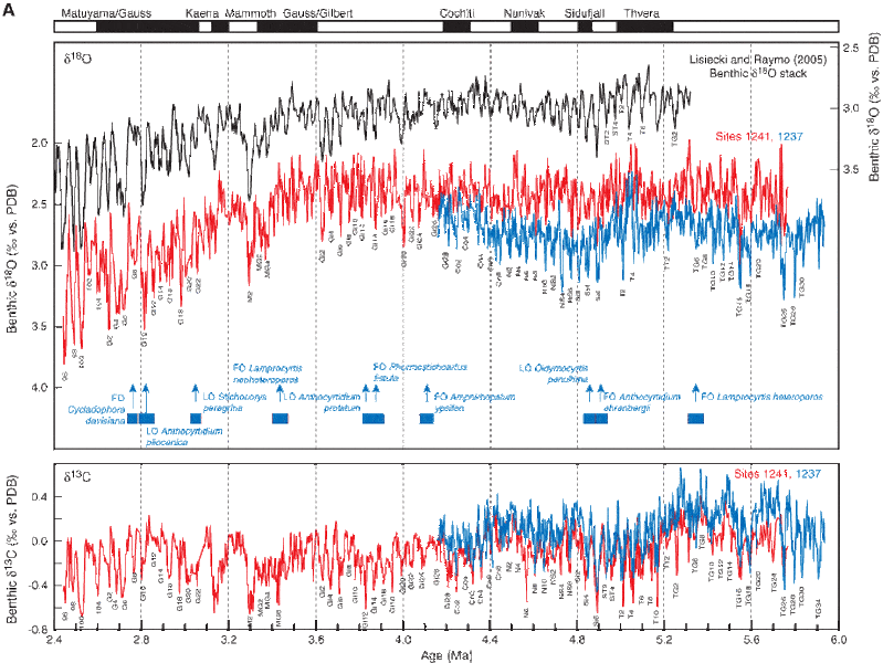

Exactly. It may also be mentioned that the paleo magnetic orientation of the Earth magnetic field is fixated in the volcanic strata and can be used for a continuous dating scale. See for instance this graph:
Note the white/black bar on top reflecting the paleomagnetic chrons, Matuyama, Gauss, Kaena etc witl alternating normal and reversed orientation of the Earth magnetic field with known reversal dates.
Source http://www-odp.tamu.edu/publications/202_SR/synth/syn_f4.htm
Yes. You can establish a record of how the magnetic field has varied with time once you know the age of the rocks concerned and use them to measure how the magnetic field varies. This effectively gives you a database, which can be correlated with magnetic readings from elsewhere to give you an inference of the age of those rocks. It's important to recognise that the magnetic field is merely a fingerprint (or distinctive pattern) that can give you a "smell" of what the age of the rocks are given prior knowledge -- you absolutely cannot tell the age of the rock given solely magnetic data and no other information.
