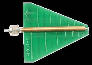

Antennas are designed and manufactured for a specific frequency range and depending on the requirements that range can be very narrow
eg. an antenna may be designed for say 100 MHz with only a + or - 5 MHz bandwidth before its losses ,due to being out of tune, become too great
but a different design may allow for a 20 MHz bandwidth before losses become unacceptable
I have an antenna for the microwave bands, because of its design can cover approximately 9 GHz of bandwidth 2 GHz to 11 GHz
