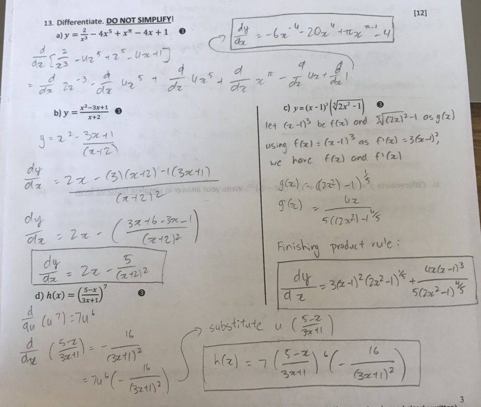

I differentiated the following questions; however, I don't know if I simplified any of them..
n/a
Thank you in advance :)
ttpp1124 said:
Homework Statement:: I differentiated the following questions; however, I don't know if I simplified any of them..
Relevant Equations:: n/a
There a couple errors. Parts a), c) and d) are fine, but b) has an error.
For b) in the 2nd line of your work you have 2x in the numerator. It shouldn't be part of that fraction. I think you also have a sign error when you used the quotient rule.
Likes berkeman
Also, in the future, please post only one, or at most two, problems at a time. Squeezing so much writing in a relatively small space makes it hard for some of us to read.
Likes berkeman

Thank you for reviewing my work. I'm sorry for cramming the questions together, will submit separate questions next time!
