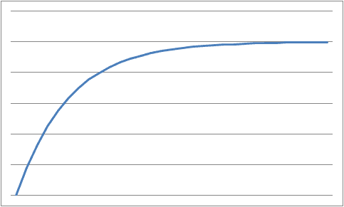

Well, here is the standard step response of the passive RC circuit:

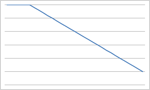

I think we can agree that this is not the integral of a step input. On the other hand, an integrator with an op-amp has this step response:

As svein points out, with RC you can only approximately integrate and your time constant must be looonnnnggg with respect to the signal of interest..
More succinctly,
your RC is by nature a voltage divider
so your output signal will be smaller than your input signal. Considerably smaller.
An opamp relieves that restraint.
Try an RC integrator with a ten second time constant .. The attenuation is so great one's signal gets lost in the surrounding electrical noise of the room. Unless he has elaborate shielding.
