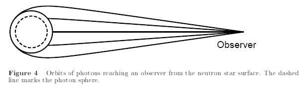

a distant observer can see more than 50% of the neutron star's surface.
That picture is nice. An observer on that equator would see 180 degrees of neutron star and 180 degrees (180° by 360°) of space same as an observer on Earth.
The sky would include more than 180 degrees of the constellations. Suppose the neutron star was near Earth and spinning on Earth's axis. An observer at the surface equator would be able to see both the southern cross and Polaris. A time-lapse photo would show non-circular rings around Polaris. Orion and Taurus could be visible on one horizon while both Lyra and Bootes were still visible on the other. When a star set it would rise on the other horizon in much less than a day. Orion would be thin at rising, get fat while overhead and then tighten his belt before setting. It would still look like a 180 degree dome. If the Sun was in orbit then it would be daylight for much more than half the day even at the equator at equinox. You would get white nights at mid latitudes during the summers.
