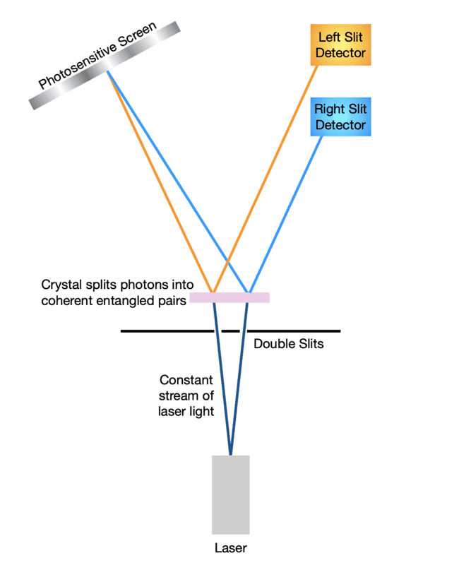

I have a really straightforward (I think) question regarding the effect(s) of obtaining the which-path information of photons that have travelled through a double slit and are hitting a photosensitive screen. In the thought experiment, all the photons arriving at the screen have entangled twins which simultaneously arrive at which-path detectors that are either ON or OFF. The set up is super-simple but I can’t find this particular configuration - so not sure if it would actually work.
A laser provides a constant stream of photons which pass through a double-slit. The photon stream emerging from each slit then passes through a crystal which splits each photon into coherent entangled pairs. One photon from each pair heads towards a photosensitive screen and the entangled twin travels toward one of two detectors (one for the left slit, one for the right slit).
When the detectors are switched to the ON position, the which-path information for each photon (and its entangled twin) can be obtained. In this case, all photons behave as particles and do not interfere with one another. The pattern formed on the photosensitive screen does not exhibit a wave-interference pattern (no light and dark bands).
When the detectors are switched to the OFF position the which-path information for each photon (and its entangled twin) is completely lost. In this case, all photons behave as waves and interfere with one another. The pattern formed on the photosensitive screen exhibits light and dark bands (standard wave-interference pattern).
Question: Assuming 100% conversion of photons to entangled pairs, can an apparatus such as this be constructed/operate such that someone can, in real time, and only by observing the photosensitive screen, know whether the detectors are in the ON or OFF position? Thanks so much!
No.
But take a look at https://arxiv.org/pdf/quant-ph/9903047.pdf for a real experiment equivalent to what you’re describing here.
Likes bhobba and vanhees71

David Charles said:
Summary:: I have a really straightforward (I think) question regarding the effect(s) of obtaining the which-path information of photons that have traveled through a double slit and are hitting a photosensitive screen. In the thought experiment, all the photons arriving at the screen have entangled twins which simultaneously arrive at which-path detectors that are either ON or OFF. The set up is super-simple but I can’t find this particular configuration - so not sure if it would actually work.
There are a lot of issues with a setup such as you describe. They get quite complicated as you dig in. A few things to note:
1. It does not matter whether the detectors are ON or OFF. In no case will there be any kind of "erasure". To the world, the information on which detector would have been triggered exists anyway.
2. Generally, entangled photon pairs do NOT provide the kind of interference you imagine on the screen. Certainly there would need to be complete erasure before this could even be considered.

Thanks, DrChinese. Let me ask a few questions to try to understand what's happening. Let's say we shoot a single photon, which travels through the double slit, and then is split into entangled twins. The detectors are ON and the idler twin is detected as either having come through the left or the right slit. From this, do we know that the signal photon will behave as a particle, and not a wave? And if we repeat the process, but place an object (like a piece of plywood) in front of the detectors, and thus lose all-which path information, do we know that the signal photon will behave as a wave?

So let me rephrase my question and feel free to rewrite it yourself if you can get where I'm leading.
My question is basically this: if we send a single photon through a double slit and it subsequently reaches a crystal which splits it into signal/idler twins, if we obtain the which path information for the idler (which alters the wave function for the idler?), does this action immediately alter the wave function for the signal photon?
There is no "wave function for the signal photon". You can't split the wave function into components, you need to consider the full wave function of the system (that's the point of entanglement).

David Charles said:
I'm trying to see if a simplified apparatus will destroy an interference pattern. I have several other questions, but I'm trying to go one question at a time. Not sure if I'm asking the question correctly. Maybe you can help.
This is not how the DCQE works. You do not "destroy" the interference pattern. The light arriving at the moving detector is incoherent. There is no interference pattern to start with. What is happening is that by using coincidence counting you can sort the full set of detections into two sets of interference patterns that are out of phase with each other (and sum up to the no-interference pattern). This sorting is only possible if you have no which-way information because otherwise the two detectors can not be mapped 1:1 to the two interference patterns.
So, no, you do not destroy the interference pattern. One rather restores it by filtering the results. In other words, one rather takes the stonemason's approach and removes detection events until the leftover forms an interference pattern. Accordingly, the answer to every single experimental variation of the DCQE experiment that uses entangled light, but does not use coincidence counting, is the same: there will be no interference pattern.
