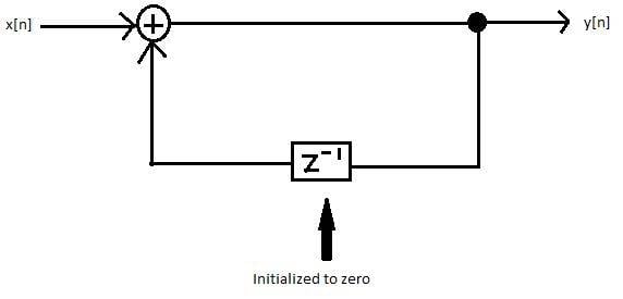

Hello, I've been working through some Digital Signal Processing stuff by myself online, and I saw a system that I wanted to write down as a Linear Algebra Equation. It's a simple delay feedback loop, looks like this:
The (+) is an adder that adds 2 signals together, so the signal from x[n] and z^-1 will be added each time until a full signal is formed for the output y[n].
However, on the first run of the loop, z^-1 is initialized to 0, so it's contribution on the first run is zero. (z^-1 will return always return whatever it was last fed, so on the second run it will have whatever came from x[n] the first time and spit that out)So we can model this system as: $$ y[n]=x[n]+ D\lbrace y[n] \rbrace=x[n]+y[n-1], \space \space \space \space \space \space y[0]=x[0]=1$$
Where: $$\space x[n], \space y[n] \space \in \space \mathbb{C}^{N}$$
and D is a size NxN linear operator matrix which represents z^-1, which acts like so: ## D[{x[n]}]= x[n-1] ##
If you want, you can generalize the system for more delay: $$ y[n]=x[n]+ D_{N}\lbrace y[n] \rbrace=x[n]+y[n-N], \space \space \space \space \space \space y[0]=x[0]=1$$

My issue is, when I try to model this with a linear algebra equation, there is recursion, and I can't seem to get a closed form due to an non-invertible matrix. I was looking at recurrence relations on wikipedia to try to solve my issue, but I guess I just don't understand them yet.
My process for modeling this in Linear Algebra has gone like so:
$$ y = x + Dy $$
$$ y - Dy = x$$
$$ (I - D)y = x $$

This matrix appears to be uninvertible, but I should be able to somehow create a closed form for this system... I just need to be pointed in the right direction.

I believe I may have solved my own issue:
Instead of treating this as a linear equation right away, something called the "z-transform" can be taken of the equation. And this allows us to easily solve the problem in the frequency domain.
(The Z-transform is the discrete time version of the laplace transform)
