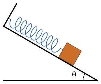

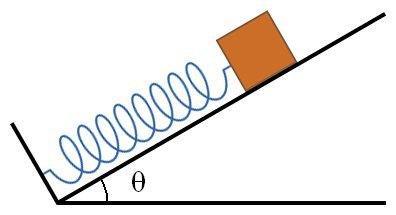

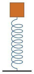

I was asked such a question:
It is known that the effective mass of the spring in this vertical spring-mass system(figure can be viewed by the following Wiki link) is 1/3 of the mass of the spring, for example, if the mass of spring is m, and the mass of the block is M, then the period of the SHO is [tex]2\pi\sqrt{\frac{M+m/3}{k}}[/tex] where [tex]k[/tex] is the spring constant.
And I found this question can be solved by the energy consideration, for example, in the Wiki demonstration:
http://en.wikipedia.org/wiki/Effective_mass_(spring-mass_system)#Vertical_spring-mass_system
Notice that there is a key step that the velocity of each position of the spring is directly proportional to its length.(which I don't know how to prove it, this is my first question.)
However, my second question is, Wiki said that the spring of the horizontal spring-mass system has the effective mass 0!
But I cannot understand why the above argument for solving vertical spring-mass system is not applicable here?!
This confuses me a lot.
Moreover, then how about the effective masses of the such following systems? (Please see the attached plots)

But the mass of the spring do play a role in the motion of the system right? My purpose is to calculate the period of such a system, from the energy consideration (in the case that the velocity of the point of the spring is proportional to the distance of that point to the fixed end):
[tex]E = \frac{1}{2}Mv^2 + \frac{1}{2}\frac{m}{3}v^2 + \frac{1}{2}kx^2[/tex]
[tex]0 = Mv\frac{dv}{dt} + \frac{m}{3}v\frac{dv}{dt} + kxv=0[/tex]
[tex]\left(M+\frac{m}{3}\right)\frac{d^2x}{dt^2} + kx = 0[/tex]
This is basically the method to calculate the period of the system.
From this argument, even if the spring is horizontal, there exists some velocity function of the distance to the fixed end, say, [tex]v(x)[/tex], then the only difference of the horizontal system to vertical one would be some change of the kinetic energy term of the spring ([tex]\frac{1}{2}\frac{m}{3}v^2[/tex] in the above case.)
If this is correct, then the effective mass of the horizontal massive spring should not be zero.
Did I mistake somewhere? :rolleyes:
Thanks!

The effective mass is the same in the horizontal configuration as it is in the vertical configuration. The easiest way to verify this is to examine the solution for the vertical configuration and take the limit as g -> 0. Since g is not in the formula for the effective mass...
By the way, this discussion helps address the my http://www.mathrec.org/old/2001dec/solutions.html" : Why is the effective mass for the resonance frequency M + m/3, but the static elongation of the hanging spring depends on M + m/2?
