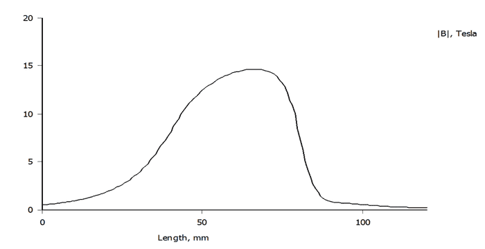

I am looking at non-symmetrical coil shapes in an attempt to "shape" the intensity inside the coil. A solenoid is generally symmetrical, so I will refer to it as a coil. Picture is the fastest way to describe what it is that I mean by non-symmetrical.

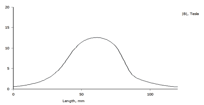

My desire in shaping the field is to form an intensity shape which is long on one side of the maximum and short on the other side. Graphs work best to show the picture here.

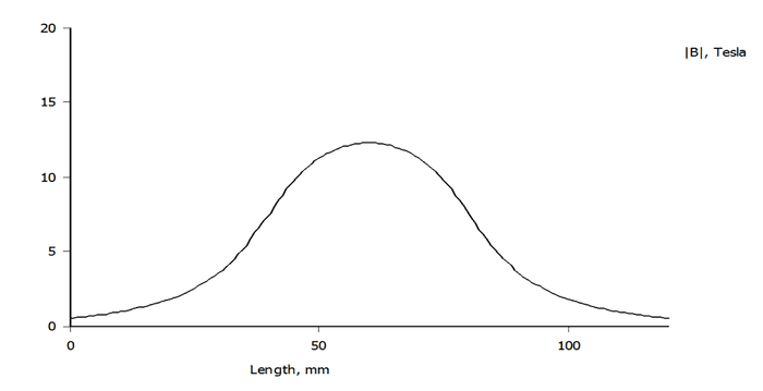

Typical Magnetic Field inside a normal solenoid:
The "Ideal" Shape for me (not realistic, just Ideal) Is for the Magnetic field to build up roughly exponentially, then drop to 0 at the exact point that the field is most intense. Because the inductor won't drop its current to 0 instantly, and ignoring any electrical "tricks" that can get it to drop extremely quickly, I am looking for a design to get me close to this:
Actualy, the ideal curve would have a perfectly flat or gently curved top (a constant magnetic field being just as good as no magnetic field, and a flat spot giving a good place to flip the current off) not a sharp pointy one, but it's already been uploaded.

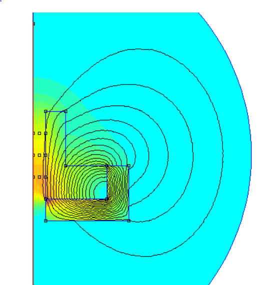

My attempt at a solution/my current work: Some brainstorming, and some FEMM simulations of what I think such a coil would look like. I have yet to do the problem by hand as I am simply looking at generalized shapes.
Coil shape:
Tried an "L" shaped coil: skinny at the top, and thick at the bottom. It caused the field to drop off more quickly and to "ramp up" more slowly:

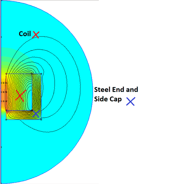

Okay, that worked, so how about MORE external Iron? or Steel? (fixed Nd magnet simulation on outside did not have any relevant effect on the magnetic field). For testing purposes to see the effects, the external material was 50% of coil length (unnacceptable length) but that did help me see what worked.
Trying different configurations of external Iron and steel: The strength of the field at the center was raised considerably, and the magnetic field wanted to drop off more quickly outside of the coil, as the flux lines are being redirected. Iron helps, but not a whole lot.

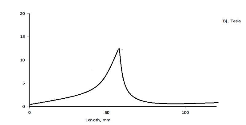

Curve from Grade A carpenter's silicon steel:
placed like this
As a side note, the steel increased the magnetic field in the center by 50% compared to 8% for pure iron. The corner of the steel closest to the "Exit" (bottom in pic) of the core was magnetized to 23T in simulation (almost 100% more!). And about 19T in center. (I realize that specific numbers here are not helpful, but the general trends and % increase are).
A few other magnetic steels had the same effect. A different material called supermalloy was the best, with over a 100% increase in core field strength and a much greater field falloff curve. (Incidentally, if any physics majors need a ~30T-50T field for a few milliseconds, simulations say it is pretty dang easy to do. You could easily sustain the field too if you had liquid nitrogen cooling. All stuff available at a typical university!)
So, it seems clear that an external end cap can help "cut off" the field more quickly.

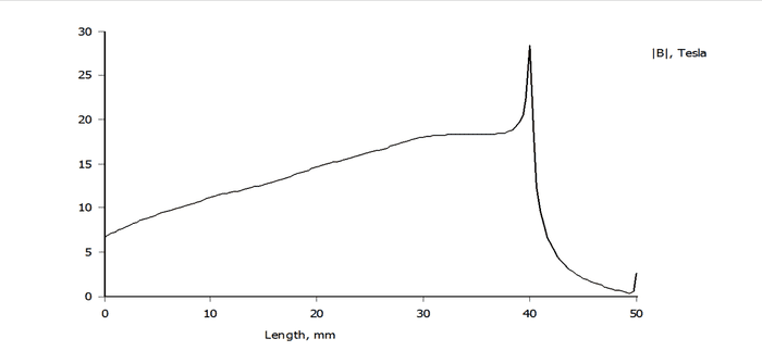

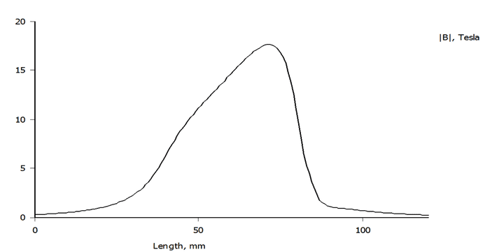

Combining the "L" shape with Grade A carpenter's silicon steel:
Shape for simulation:
Simulation results through center of core:
Simulation results through the innermost edge of the coil and steel external piece:
This seems pretty close to what I want (The picture two above! the one directly above is just a "cool" pic) I am thinking about trying ramps rather than the "L", trying an extremely thin piece of silicon steel (coil you see is 40 mm tall, by thin I mean 1/2 -1 mm) along the inside of the coil. Do you guys think that would be a good idea? Are there any problems with these sims, that FEMM doesn't realize or that I am doing wrong? (will the external material "steal" the energy that would go to a ferromagnetic object in the core?) I'm asking this before I spend more time doing simulations. I think that I am on to something here with the combinations, I just won't know until I can build models in the lab: one of a normal solenoid, and one that I design, both with the same calculated inductance and resistance. Obviously, I would like to run simulations and think a lot before I purchase wire and high grade steel and spend a long time winding the cores.
Note: All simulations graphs show field strength from about twice the distance of coil length, through center of coil, to same distance away. 0 is the "top" shown in simulation pictures, and the maximum is the "bottom". The top is the coil "entrance" and the bottom (Where the external material is) is the "Exit"

I'm not sure I understand your question. I think you want to generate a field with a sawtooth-shaped intensity plot. I think that is not even approximately possible because every turn of the coil generates a field that drops off gently on each side, sort of like your second figure. To find the field generated by a coil of any shape, use superposition, i.e. add up the contributions of all the turns.
Do this mentally and on paper to see what is going on. Do not use simulation at the conceptual stage because it hides what is going on and may mislead you. Use simulation only to get an exact solution for a particular design and to refine the design.
When you talk about current dropping to zero instantly (about par. 5) it seems you are confusing current vs. time with field intensity vs. distance.

The second figure is exactly how a normally-shaped field would be. Thinking of these with superposition is how I got the figures I ended up trying to simulate (The "L" and where to put the external material" but actually doing those problems on paper is much harder than running a simulation which takes ~2 minutes, and gives a nice graph of field strength through the center to confirm the initial concepts.

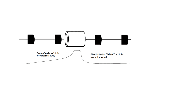

I'll draw up a diagram to help explain why I am interested. (Also, a solenoid-based accelerator would be a coilgun, not a railgun. This is a linear motor: This would use the same principle as a coilgun, except that I don't need a huge discharge from a capacitor into the coil for rapid acceleration like they do. And yes, I know that this is not an efficient way to accomplish this, there are easier and simpler methods, etc.)
Links in "front" of the coil will be more affected than links which have already moved through the coil, if the current is briefly shut off right as the link reaches the peak until it is carried away. with a few coils
