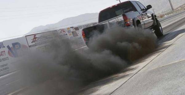

I would like to understand if someone has tried/or atleast if its feasible to make a Electrostatic precipitators that captures automotive pollution from sources like this?
Does the physics allow to do that?

The Physics is OK, I think. The problem would be the massive volume that the device would take up in a motor car, in order to deal with the vast amount of particulates without restricting the rate of flow of the gases.
It should not be necessary to use an exhaust filter. Black particles are produced only when incomplete combustion occurs.
There are several causes of incomplete combustion.
1. Cold engine or faulty glow plug. Fuel condenses on cold wall then burns slowly.
2. Blocked air filter. Insufficient air to burn all the fuel injected.
3. Faulty injector. Dribbles rather than atomises the fuel.
4. Blocked fuel filter or low fuel. Injection pump spits rather than atomises the fuel.
5. Insufficient compression of air in cylinder. Failure of cylinder seals or turbo charger.
6. Too rich fuel. Maximum fuel setting on the injection pump is too high for the fuel being used.
Black smoke is an indication of a failure. Fix that fault and you will not need a particle filter.

An electrostatic precipitator would have problems with carbon particles as they would tend to short circuit the high voltage. If a filter was now needed it might be better to use a HEPA filter once the engine reached operating temperature.
or a gearhead has "performance tuned" his electronic engine control unit
I agree to the above points that the technology is improving in a way that emissions can be fixed via repairs, upgrades. However, Particulate matter is the biggest cause of pollution in developing/thirdworld countries where 70% world population lives. The problem is- people don't maintain their cars.
My question technically is about miniaturizing ESP in a way that it can be retrofit behind vehicles who don't take their vehicles for repairs. Whether you maintain your engines- atleast you'll not pollute the environment.
