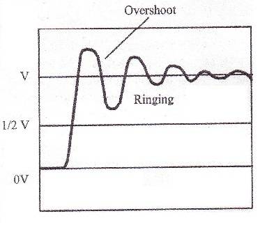

If you have an impedance mismatch, the resulting waveform will often show ringing:
Oh, it seems interesting. Maybe I will learn it laterly in wave formula. Thx
