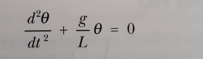

I need the demonstration of the simple pendulum "hourly law".
I've attached images
I've just studied simple pendulum: The simple pendulum (for small oscillations) differential equation is first image.
I've no problem to arrive this result and formula.
My problem is to get to the second formula by passing through another formula (Image 3) that my book mentions. I can't understand the passage.

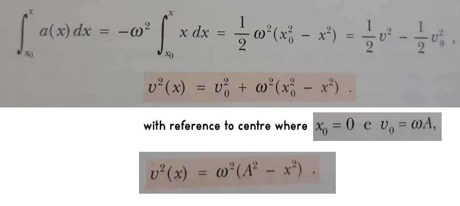

Image 3 refers to acceleration expressed as a function of the position, is a simple harmonic motion.
In the image 3 last formula refers to centre where x0 = 0 and v0=ωA
My book: "For small oscillations the diffential equation becomes that of image 1 and coincides with that of the simple harmonic motion shown in image 3 set ω2 = g / L.

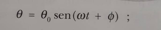

And then arrives at image2.
I would need to switch from the first to the second formula.

Image 1
Image 2
Image 3

If ##\theta## is small, then the ##x##-coordinate of the pendulum bob is ##x = L\sin{\theta} \approx L \theta##, hence if ##\theta## satisfies ##\ddot{\theta} = -\omega^2 \theta##, then ##L\ddot{\theta} = -\omega^2 L\theta \implies \ddot{x} = -\omega^2 x## in this regime. The integral they wrote down gives$$\int_{x_0}^{x} \ddot{x} dx = \int_{x_0}^x -\omega^2 x dx = \frac{1}{2} \omega^2(x_0^2 - x^2)$$However, since ##dx = \dot{x} dt##, you could also write that very same integral as$$\int_{x_0}^{x} \ddot{x} dx = \int_{t_0}^{t} \ddot{x} \dot{x} dt = \int_{t_0}^t \frac{d}{dt} \left( \frac{1}{2} \dot{x}^2 \right) dt = \frac{1}{2}v^2 - \frac{1}{2}v_0^2$$Hence, equating these gives$$\frac{1}{2} \omega^2(x_0^2 - x^2) = \frac{1}{2}v^2 - \frac{1}{2}v_0^2 \implies v^2 = v_0^2 + \omega^2 (x_0^2 - x^2)$$Does that answer your questions?

how can i pass from $$\ddot{\theta} + \frac{g}{L} \theta = 0 $$ to $$\theta = {\theta_0} \sin({ωt} +∅)$$
with ω2 = g / L.

This is a second order homogenous differential equation in ##\theta(t)##. As with any differential equation of this form, you can trial solutions of the form ##e^{\lambda t}## and then write the complementary equation,$$\lambda^2 + \frac{g}{L} = 0 \implies \theta = \pm \sqrt{-\frac{g}{L}} = \pm i \sqrt{\frac{g}{L}} = \pm i \omega$$where we defined ##\omega := \sqrt{\frac{g}{L}}##. This means that our general solution is $$\theta(t) = Ae^{i \omega t} + Be^{-i \omega t} = (A+B)\cos{\omega t} + (A-B)i \sin{\omega t}$$or more simply, by collecting those coefficients into two arbitrary constants$$\theta(t) = C\cos{\omega t} + D\sin{\omega t} = E \sin{(\omega t + \phi)}$$Now you can use the boundary conditions to determine ##E## and ##\phi##.

The pass is briefly as follows (this is in homework section so i cannot say the full details)
First we make two guesses that the functions ##f_1=\sin\omega t## and ##f_2=\cos\omega t## (##\omega^2=\frac{g}{L}##) verify the differential equation. Hence we know two solutions.
We know that these two solutions are linearly independent.
Then there is a theorem from the theory of vector spaces and differential equations that if for a linear differential equation of order ##n## we know ##n## linearly independent solutions ##f_1,f_2,...,f_n## then the general solution is $$f=\lambda_1f_1+\lambda_2f_2+...+\lambda_nf_n$$ where the ##\lambda_i## are any real numbers.
We apply this theorem for n=2 (the order of differential equation in this problem is 2). Then it is a matter of some trigonometry and simple algebra to prove that the general solution is equivalent to the form given in your post. (I see now that @etotheipi has posted something relevant to this).

Just to simplify things a little. It is difficult to ab initio generate the solution to image 1 and obtain image 2...this is the stuff of entire courses on differential equations.
Happily for the purposes of this exercise it is necessary only to show that image 2 is a solution to image 1. This requires only the ability to take derivatives of trig functions. The rest is all correct but not really necessary and probably off-putting.
