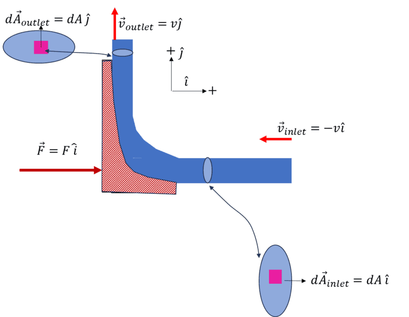

Hi,
Case 1:
Imagine a steady liquid water jet with unit cross sectional area - incompressible and inviscid. density D and uniform velocity V. Operating atmospheric pressure is 0.0 Pa.
The jet is in air ( no air resistance ) and hits a stationary flat plate perpendicularly.
Applying momentum equation gives - the force on the plate by the water jet as : D*V*V = DVV.
Hence the pressure on the plate = DVV / Area = DVV. (Area = 1)
Case 2.
For the same scenario the Stagnation pressure is = 0.5*D*V*V = 0.5 D V^2
The stagnation pressure is the pressure just before the plate, when the fluid completely stops on impact.
However, the two answers are different.

It depends on where the energy goes in the collision and flow. The momentum equation by itself is not the whole story...we need to do energy accounting as well. The Momentum Equation works in concert with the First Law of Thermodynamics. Fundamentally, you "think" you are finding "strange things" because you are applying one without the other.
You also have to be careful about mass conservation. If a flow is hitting a flat plate it’s being deflected. Bringing the flow to a complete halt (as you do in one of your scenarios ) you are unintentionally accelerating the flow from ##v## to 0. Where is the mass going? That is not steady flow, you have to account for momentum accumulation in the control volume as well. In that scenario there must be non-conservative work done on the flow. All the energy it had on the way in must be lost to heat.

I disagree with the statement that you must solve the energy equation. The nice thing about incompressible flows is that the energy equation is decoupled from the mass and momentum conservation equations, i.e., you can get forced without the energy equation.
The reason the Bernoulli equation approach outlined above does not work is that it only applies at a stagnation point. That's a single point rather than the full redirected flow against a surface. For the total force on the plate, you need to look at the total momentum change normal to the plate.

I feel like the decoupling is the exception, not the rule. I agree that I can find ##\vec{F}## without considering energy here:
But I also think this is only possible because of all the "strictly untrue" assumptions I made.

Is the flow involved a transient flow (sudden start-up of the jet against the wall) or is it steady flow? If it is steady flow, then the issue is resolved by noting that, by the Bernoulli equation, the kinetic energy is constant; the axial kinetic energy of the jet before impact becomes the radial kinetic energy of the sheet of fluid spreading radially on the plate. The fluid jet does not stagnate at the contact. The axial momentum equation is also satisfied by condition that the force exerted by the plate on the fluid is equal to ##\rho v^2 a##. How this axial force is distributed on the plate is a more complicated issue.
