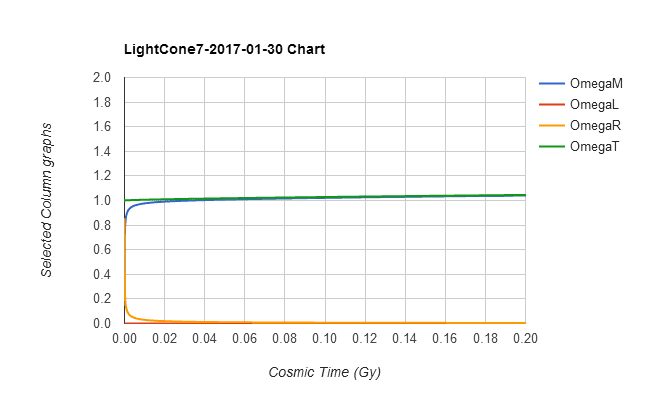

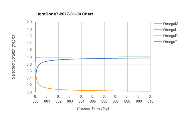

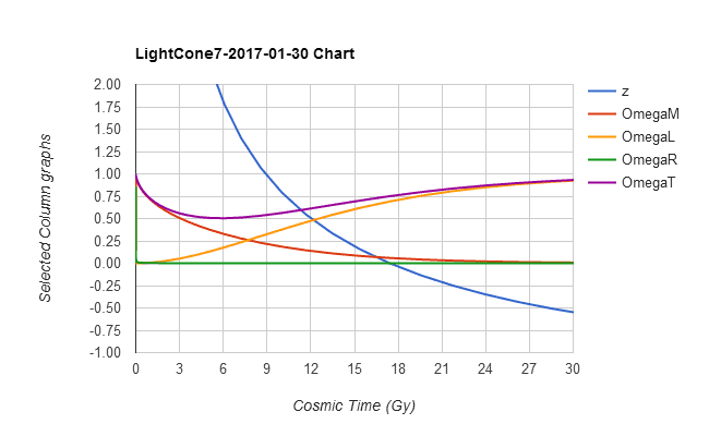

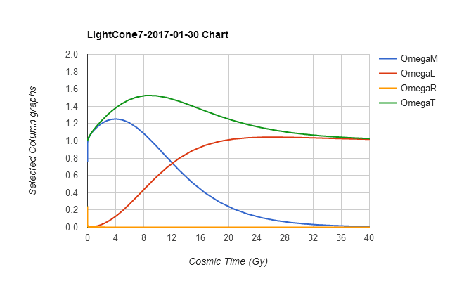

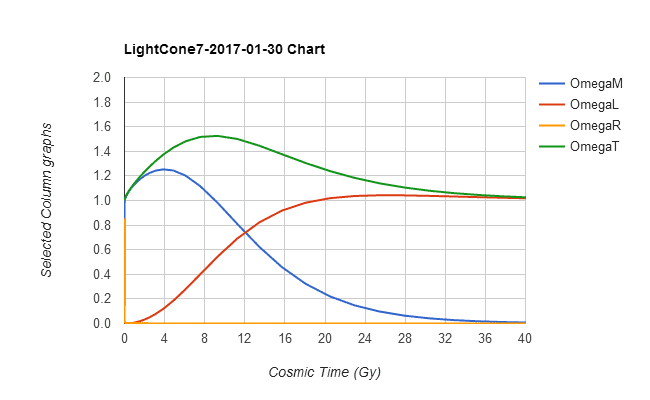

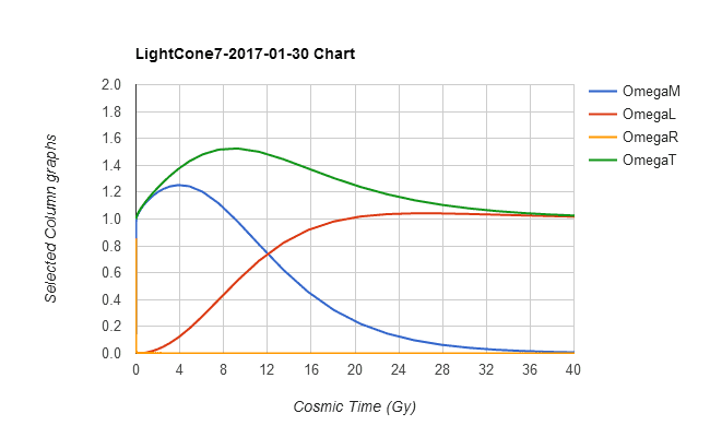

Here is a trial version with consistent column number formats. I have tried 2 decimal places as default and I must say it looks less intimidating than the mixed bag of the previous versions. Temp-link: LightCone7-2017-01-30 Cosmo-Calculator.
I have added a column for the evolution of the total density parameter (OmegaT, just the sum of matter-, radiation- and Lambda-energy). It is uninteresting when Omega=1, but the evolution of Omega is very interesting in cases where the present Omega <> 1, e.g. for Omega = 0.75 (the minimum, that the calculator allows):
Note how OmegaT starts at ~1, evolves away from 1, all the way down to OmegaT~0.5, and then back up to approach unity again (as OmegaL dominates). As a sanity check, it passes through 0.75 at present time (z=0), which for Omega=0.75 is at T=17.4 Gy.
I hope I'm right with these calculations in the software - if anyone cares to check the results, it will be highly appreciated.
Looks much better, I'll play around with it but looks good thus far
shouldn't the formula be assymptotic?
If you are referring to the total density parameter ##\Omega##, when ##\Omega_\Lambda > 0##, it goes asymptotically to 1.0. I think if ##\Omega_\Lambda =0## identically, it depends on whether ##\Omega_{now}## is larger or smaller than 1, going asymptotically to either infinity or zero. Not sure of this.
[Edit]
The calculator seems to indicate that for ##\Omega_\Lambda \approx 0## and ##\Omega_{now} > 1##, the eventual collapse will cause an exponential rise in ##\Omega## towards infinity. Which seems right for any 'big crunch'.
As a further check, does this correctly represents what the LCDM model predicts for the value of ##\Omega(T)##, given a present (hypothetical) ##\Omega##=1.5?
I.e. the total density had to start very close to unity, then evolved away from that during the radiation/matter dominated era. Dark energy domination then drives it asymptotically back to approach unity again.
At early times, ##\Omega(T)## appears like an abrupt deviation from unity, but a zoom to early times indicates that it is also an asymptotic deviation from near-unity.
At the earliest time that the calculator can handle (z=20000, t~1000 yrs), ##\Omega(T)## ~ 1.0005 and it evolves like this, according to the calculator under test. So, the 'abruptness' is just a matter of the scale.
