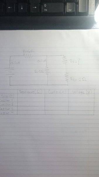

Examine the following circuit and complete the table

so for resistance I've gotten r1=6 r2=5 r3=8 and r4=12. then for current i got r1-.30 r2=.24 r3=.06 r4=.06 amd volatge r1=1.8 r2=1.2 r3=.48 r4=.72. I am not sure about my voltage for r3 what i did was Vt-r1-r4 and when i add them up i get 3v so that should be right? and I am also not sure about resistance total or my r3 for my r3 i did...
R3=V3/I3=.48V/.06A=8 is all my information right?

Yikes, I tried processing your image, and it's still really hard for me to read... Can you say in words what it shows?
We need to know what data the problem came with. It is difficult to tell the difference between what you were given and what you have calculated.
