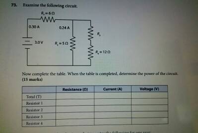

Examine the following circuit. Now complete the table.

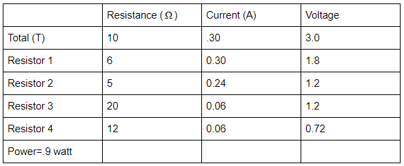

Your value for R3 is incorrect (it's R3+R4).
Rest of the answers are correct.
Likes Sainvictus
Sainvictus said:
R3 is incorrect and voltage across R3 is also incorrect.
Likes Sainvictus
