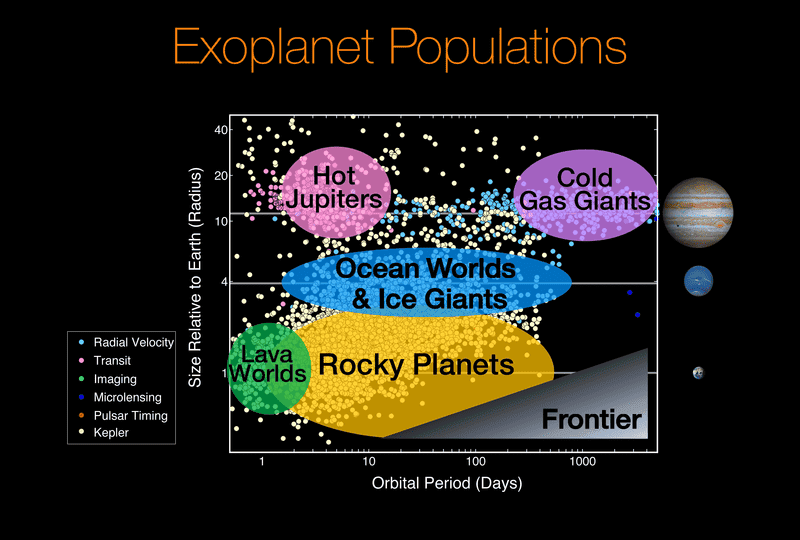

We do see smaller and more distant planets. Hundreds if not thousands have been detected.
Here's a graph showing some of the exoplanet's we've discovered. Notice that a large proportion have orbital periods of less than 10 days, which is to be expected since those are by far the easiest to detect. But also note that roughly half of the exoplanets on this chart have orbital periods of more than 10 days, many having orbital periods of 1000 days and beyond. Also, the overwhelming majority of these exoplanets have masses much smaller than Jupiter.
