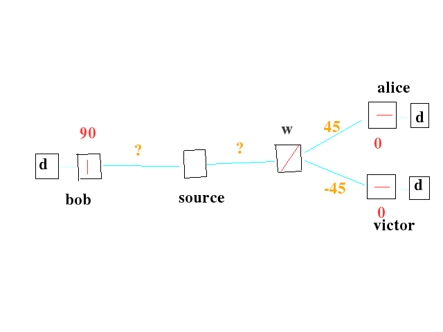

I am not sure I get your point, so I made a sketch of the setup, with separate polarisers and detectors:
My question is what if it turns out that alice/victor and bob continue to get perfect anticorrelation despite the fact that the wollaston prism polariser is there? Or in other words, how are we sure that "w" (Aa) will "destroy" entanglement?
Bob and Alice's measurements will be independent. I'd say this is a result of standard quantum mechanics and not an open question at all.
P(Bob)=50%
P(Alice)=25%
P(Alice ^ Bob)=12.5%
P(Alice ^ Victor)=0
There is more rigorous way how entangled state can be analyzed.
Keeping it simple after the source each beam of entangled photons contains H-polarized and V-polarized photon modes. In first beam splitter they can interfere and create so called non classical effects. But at the outputs of first beam splitter there are pure H-polarized (in one output) and V-polarized (in other output) modes so there is nothing that can interfere in subsequent polarizer.
