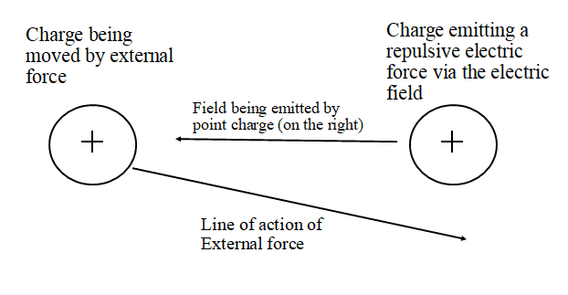

Not necessarily. The force need not be constant, and the field could be non-uniform. Consequently, we do not know whether the momentum at the end is taking it to a higher potential energy or a lower.
E.g. imagine the field being generated by a point charge, and a constant force with a line of action that misses the point charge to one side. At first, force is doing work against the field, but eventually it will be going the other way. Turning off the force will leave the particle gaining speed as it accelerates away from the charge.

Like this, right?
So you are saying that initially the charge is being pushed directly against the force from the electric field, but once the charge gets to a point below the point charge emitting the electric field, it will immediately be accelerated downwards and not necessarily slow down first.
It can be assumed that indeed the electric field force is not constant because as you get closer to the point charge the repulsive force will be greater, and the external force is not constant too because more external force will have to be provided to overcome the increasing repulsive force... But for the sake of introductory physics we can assume that the charge is moving directly head on to the other charge, in which case what we said about the charge slowing down then being emitted west will then apply, right?
well, not directly against even at the start, so at the same time that the force is pushing it one way the fixed charge is pushing in another direction. Consequently the trajectory will curve around.
If the force is weak compared to the electric force, it may be that the potential energy never increases, but decreases right from the start. Nevertheless, it remains true that the work done by the external force is ΔKE+ΔPE.
Yes, but of course no finite force would be enough to push the particle all the way to the fixed charge.
