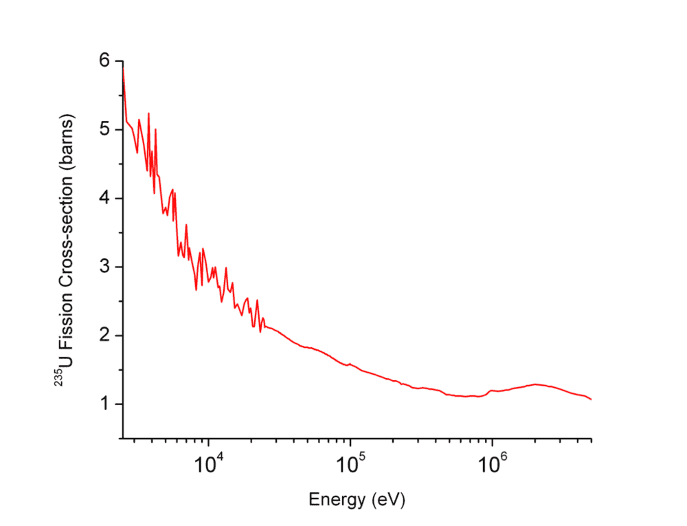

The biggest issue is the amount of fissile material present. A reactor with an efficient moderator can have much less fissile material relative to a reactor with little or no moderation.
Very broadly speaking, the reactor will be critical if, on average, each neutron in a generation results in one neutron in the next generation. That requires that enough, on average, find a nucleus and cause it to fission.
The moderator slows the neutrons down. That means that you get a larger cross section for fission. (See the graph.) So, if the neutrons are thermal, they will see that larger cross section. So they will have an easier time finding some U235.
But the cross section is not zero at higher energies. So, by working harder at the design and by putting more U235 in, you can make it critical with less, or no, moderation.
Controlling the reactor is then the challenge. You must, as anorlunda said, keep it in the regime where delayed neutrons are still the difference between critical and sub-critical.
A prompt neutron is one that is released, as the name suggests, immediately on fission. A delayed neutron is released from a fission fragment through radioactive decay. These can be emitted from seconds to minutes after a fission happens. They then follow fission power up and down, but with a delay.
If you stay in the region of delayed neutrons, then you can control the reactor quite easily. The characteristic time will be many seconds. If there is a small uptick in power, you have enough time to control it using fairly ordinary mechanical systems. If you get into the region where the reactor is critical without delayed neutrons, called the prompt region, then the characteristic time is milliseconds. Or possibly even a fraction of a millisecond in some designs. Such situations can't be controlled by normal mechanical systems, and you get huge extremely bad problems. Explosive in some designs.
So a "fast reactor" means that the neutrons average faster, not that the reactor is doing anything unusually fast otherwise. Broadly speaking, things are quite similar except for:
- The spectrum tends much more strongly towards the higher energy parts.
- The fuel tends to have much higher concentrations of U235. Or other fissile material if it is another fuel type.
https://en.wikipedia.org/wiki/Neutron_cross_section#/media/File:U235_Fission_cross_section.png
