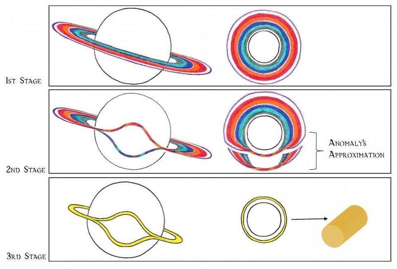

Planetary ring: Formed only 1 million years ago, from a fourth moon that slowly approached and, eventually, entered the Roche’s limit, collapsing into a ring around the planet.
- Loren, you mentioned that the event originating the ring system must be geologically recent, with the tidal forces of the star tearing it apart as time goes on. Now on top of that, I’m picturing the eccentricity of this planet’s orbit to be generated by the influence of other planets, maybe gas giants. Accounting for these two factors: the star and the other planets influence, would the ring system hold itself for at least 300.000 years? Knowing that anatomically modern human beings date from at least 200.000 years, I would like that the native intelligent life coexisted for, if not all, at least a great length of the ring system’s life span.
Aside from this initial ring formation, I’m planning for it to leave its natural aspect due to the approximation of an anomaly that will alter it’s original form as shown below:
- I’m assuming the 3rd stage, and final form, does not have that much of an impact on the temperate zone’s climate, as you mentioned for the 1st stage ring system, due to it’s much thinner width. Additionaly, with the 3rd stage cylindrical shape, I’m also assuming it is now visualized equally from any given location on the surface of the planet.​

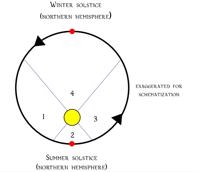

Orbital eccentricity of the planet, axial tilt and seasons: As mentioned before, both the planet’s orbit and its axial tilt are greater than Earth’s, with the intent of having asymmetric and sharply different climates between them. Although its not a priority to achieve precise figures for these parameters, I need to know if the numbers I’ve got sound plausible – four seasons on the temperate zone, with 390, 240, 390 and 477 days and their respective temperature variations. Aside from that, here are some other issues:
- The Kepler’s Laws are bugging my brain about where to place the solstices and equinoxes. To illustrate the question:
- Unless I’ve understood something wrong, our actual seasons are divided conventionally to match the solstices and equinoxes. I preferred to set the season divisions exactly at the middle of such events, so that the coldest point of winter would be at it’s middle, and the hottest point of summer too. With an eccentric orbit, however, it got unclear to me where these solstices and equinoxes should be. Looking at the picture, it seems like the solstices would happen right in the spatial middle of the seasons they refer to, namely, around the day 120 of the season 2, and the day 238 of the season 4. Supposing that logic is right in the first place, I still don’t know where should the equinoxes be.

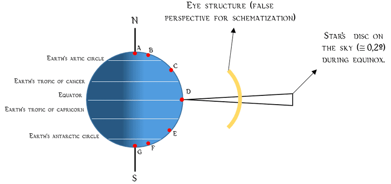

Eye on the Sky: To clarify what I have in mind, here is a schematization:
- Consider that the center of the eye structure is always aligned exactly between the planet’s and the star’s centers of mass. Is there a combination of the width of the eye structure and it’s distance from the planet that allows the star to be, from the perspectives of observers on the ground from points A to G, always inside the eye structure? I know a simple way to do that would be expand the eye to a width above that of the planet, but, maintained the proximity, that would also make it surround most of the sky, thus loosing it’s ‘eye’ similarity.​
Any question answered greatly advances my setting’s details and verisimilitude, so thanks again for your replies.
Wow. I can't speak for the luminosity and other characteristics you cite, but the rings disturb me.
What mechanisms cause the diversion? Even shepherding moons would not do something so strange.
Each particle in the ring obeys orbital mechanical laws, so imagine a spaceship in orbit following that twisted path. Each deviation in the orbit requires energy to turn it out and then back in. Where is that energy coming from?
If it is the planet, then something must give due to the law of conservation of energy.
I think a standard ring would be fine for the ages you describe, but I can't wrap my arms around what you propose.
