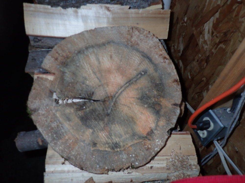

How's this for a shrinkage crack? The disk is 14" diameter. My wife wanted a wood disk for an art project.

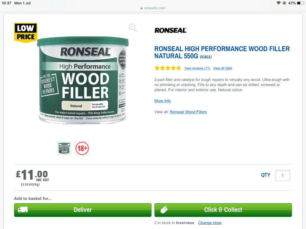

Use a two-part epoxy type like this one ^^
The weak part is the join to the wood which will eventually fail and allow the filled segments to peel out. Some staples or panel pins (galvanised) hammered in before the filler will help anchor things.
You can grain the filler with a segment of hacksaw blade.

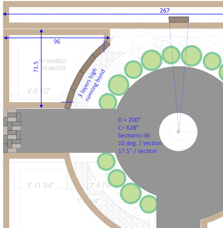

Thanks. This is part of my sketch:
