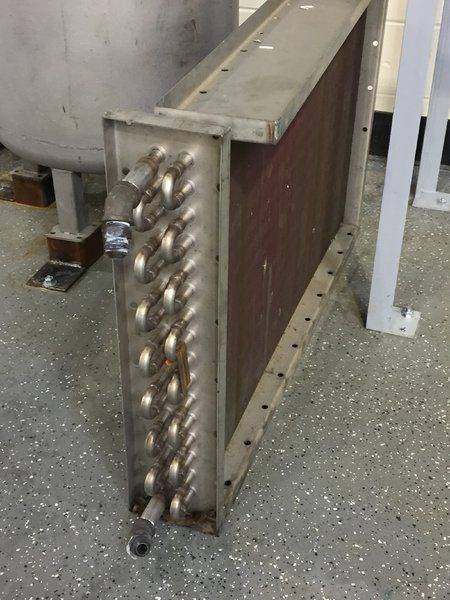

I am currently working on a project which requires a mass and energy balance on a fin/ fan heat exchanger. The problem I am running into is finding how to apply the fin efficiency to find out the amount of hea tbeing dissipated through the fins. The hot fluid is water and the cooling fluid is air.
Question: How do you find the amount of heat going through the fin/fan?
Problem :
Given:
Base area of fan A=.62 m2
OD of tubes= 15.8mm
ID=unknown
number of tubes = picture included.
Cross Flow one pass fluids unmixed

Attached find a picture of the exchanger base with tubes

250,000 CFM through that tiny little coil? Not likely. Take another look at how you got your air flow rate.
And why are you looking at fin efficiency? I'm curious because that is normally of interest only to the person designing the heat exchanger, not somebody doing a mass and energy balance.

This is being done as a project in class. The air flow rate was acquired by use of an anemometer. All the units were in GPM the bulk fluid properties were looked up. A typical anemometer reading from our experiment showed the inlet and outlet flow ranging from 1200-1600 GPM where the anemometer reads that as “1600x100”. That was a topic of discussion in class as the instructor wasn’t sure if the device was already multiplying the figures by 100 to get the readings. An example being “ is it 1600x100 to get 160,000? Or was it 16x100 to get the reading 1600”. If you could clarify that issue it would be tremendous. I plan on going back into the lab to find the model of the anemometer.
I personally am curious about the fin efficiency because I stumbled upon it in a book I had and figured it would contribute something to the overall heat coefficient.

Are you certain about units in GPM? An anemometer measures air velocity.
Edit: 310.7 pounds/sec of air mass flow works out to 3884 cubic foot/second (233025 CFM) at 0.08 pounds per cubic foot. Heat exchanger air area (not figuring for the reduction of open area by the fins and piping) is 0.62 m^2 (6.67 sq.ft). This yields an air velocity of 34936 FPM; an air speed of 397 MPH doesn't seem likely.
