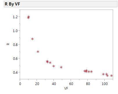

In summary, the goal is to find a function/transform "F" that can be applied on the variable recorded in the third column ("col3_val") such that the coefficient of variation of all the "R" values is minimized. The CV should definitely be less than 3%, but I expect a good solution could easily make it less than 1%. A plot of the R values against VF values should show no trend/pattern, where Ts is the total time for each log (i.e., the value in the last row of the first column for each log).

Additional Constraint: A plot of the R values against VF values should show no trend/pattern, where -->
  • VF = [#.log_val]/[Ts]
  • "Ts" = the total time for each log (i.e., the value in the last row of the first column for each log)
See an example of the trend when no transform is applied in attached jpg.

The unchanged function looks close to $$ R \approx \frac{1}{VF} = \frac{Ts}{[\#.log\_val]}$$The dependence on #.log_val follows its definition: $$R=\frac{[W\_log\_Val]}{ [\#.log\_val]}$$ which is suspicious.
