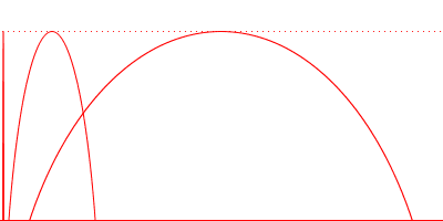

Consider these three baseball throws:
Knowing nothing else, at a guess, do you expect the three of them to have different flight times?
What if I told you they were not three baseball throws, but only one, just viewed from different locations on the field? What would you say about flight time now?
Likes gmax137 and phinds
