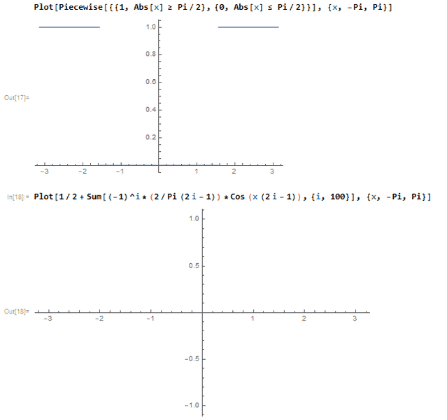

As a side question. How do I graph the function ##f## and the Fourier series in Mathematica? I have tried the following but the Fourier series does not show up.

In your second plot, your Mathematica notation might be wrong. I'm not very knowledgeable about Mathematica, so I might be mistaken.
In the factor right after (-1)^i, you have 2/Pi (2i - 1). I think that you believe that this is ##\frac 2 {\pi(2i - 1)}##. It's not.
This would actually be evaluated as ##\frac 2 \pi (2i - 1)##
I believe this factor should be 2/(Pi * (2i - 1)).
Also for the cosine factor, you are missing an operator for multiplication. This might not be a problem in Mathematica, but it is a problem in virtually every other programming language. I believe this should be Cos(x * (2i - 1)) or Cos((2i - 1) * x).
Likes lesdes

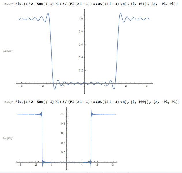

Yes thank you! I totally missed the parentheses there and I also noticed that I butchered the syntax of Mathematica. It should be Cos[] and not Cos(). Now I have
the following plot for ##n=10## and ##n=100## for the Fourier series
So my Fourier series is correct then, I suppose?
Those look right on the money! Well done!
Likes lesdes
