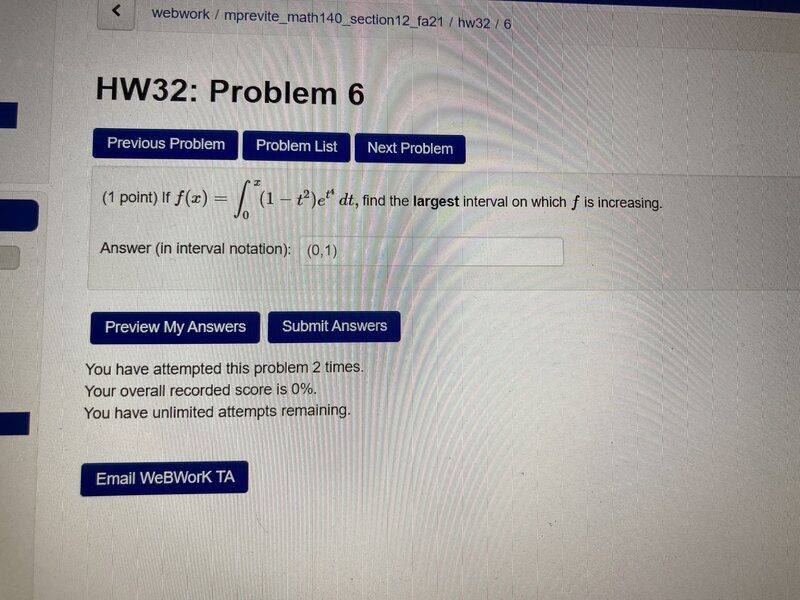

Attached here is the full problem I am doing.

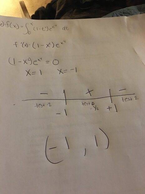

I went through the problem and got my final answer which I thought was correct. Here is my work. They tell me I am wrong. Not sure where is the mistake.
FactChecker said:
Your hand-written answer looks good to me. Did you type in the answer in the first photo? That is wrong.
I tried both -1,1 and then was trying out other answers to see what the program was selecting.
Should you include the endpoints to get the "largest" interval?
Maybe the problem is distinguishing between increasing and strictly increasing. For f increasing (i.e., ##f' \ge 0##), the interval is [-1, 1]. For strictly increasing (##f' > 0##), the interval is (-1, 1).

f can be strictly increasing on an interval where its derivative is zero. For example ##x^2## on ##[0,\infty)##, the only time it's zero is at zero so you can include it in the interval and it's still strictly increasing. It's actually only degenerate examples where you can't include it.
I was probably conflating the concept of an increasing/strictly increasing function vs. the derivatives here. It's very possible that the software was looking for [-1, 1] instead of (-1, 1).
