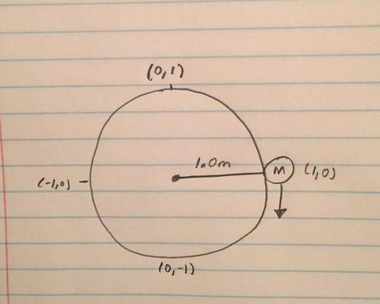

A ball of mass M is attached to a 1.0m pole that is pivoted on the wall at point (0,0); such that it can take the path of a circle. The ball is initially held up at rest at the point (1,0). It is then pushed with a downward force.
What minimum initial velocity must it have if it is to be able to travel all the way around the circle of radius 1.0m ?
(It must be able to get back to the point (1,0)

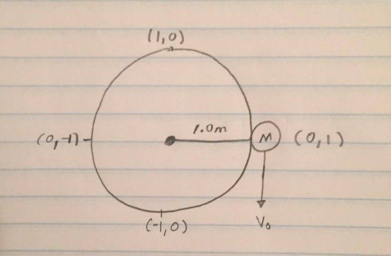

here is a diagram of the situation
Were you given that diagram?
The Cartesian coordinates of a point are denoted (x,y) where x is the horizontal measure from the origin, y is the vertical measure from the origin.
EDIT: You've attached a diagram you already know is wrong? Why not fix it first? How much help will this be to other students trying to follow along?

ok here is the corrected diagram. I know about Cartesian coordinates and yes that's what i use but i am a dyslexic so sometimes i get things switched around.
