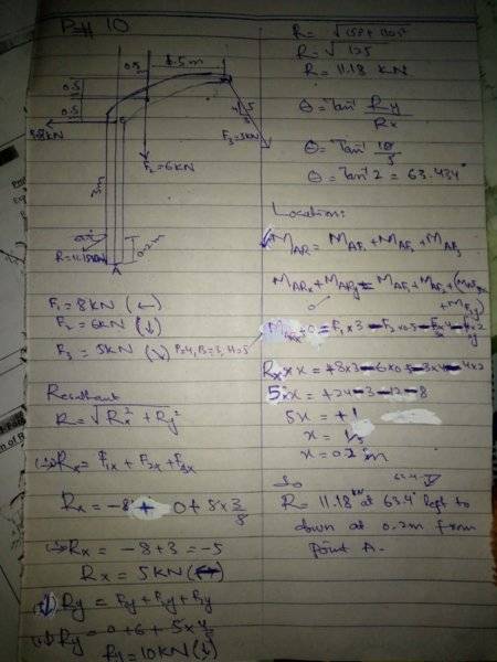

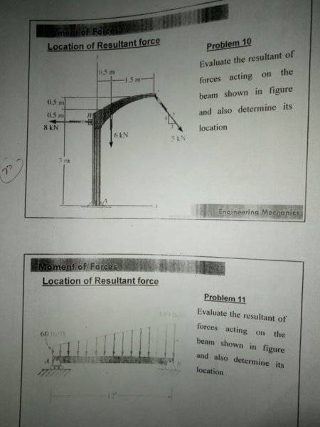

Find the resultant using the principle of moments

problem number 10
So are you asking for us to tell you if you have the right answer? That may be why you haven't gotten a response, yet.
Your answers are all correct, but you could express them a bit more clearly.
I would have written, maybe "... kN to the left at .. below the horizontal, acting through a point ... m above A".
