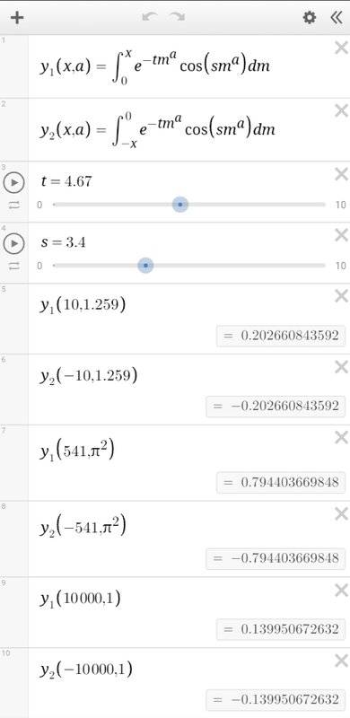

I next booted up Desmos' Online Graphing Calculator and graphed $$y_{1}(m)=\displaystyle{\int_{0}^{m} (e^{t x^{\alpha}} \cos(s x^{\alpha}))} dx$$
$$\text{and}$$
$$y_{2}(m)=\displaystyle{\int_{-m}^{0} (e^{t x^{\alpha}} \cos(s x^{\alpha}))} dx$$
using a range of random values for the constants. Through this I was able to confidently come to the conclusion that, as ##m \rightarrow \infty##, ##|y_2| \rightarrow |y_1|##. Therefore;

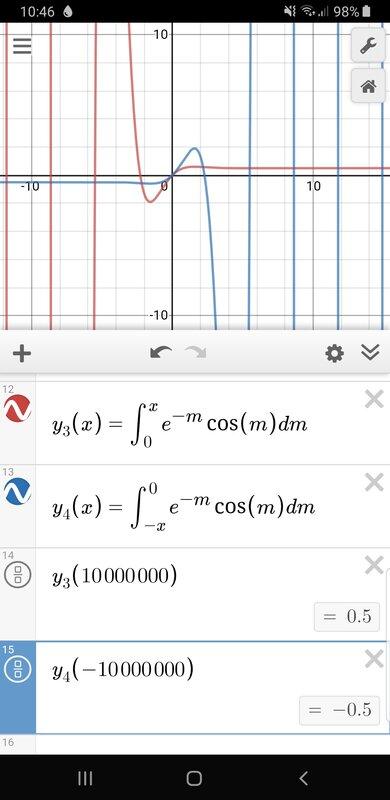

Thanks for the reply. I did the testing regarding this part using Desmos, which said that the integral should be converging to ##1## for the constants all equalling ##1##.
In fact, Desmos indicates that the integral converges so long as all the constants are are greater than ##0##:
Desmos seems right, however you do a "tricky "mistake in the integral setup of ##y_4## or##y_2## or you ask for the wrong value,
for example since you setup $$y_4=\int_{-x}^0 e^{-m}\cos m dm$$ and then you ask it for $$y_4(-10000000)$$ Desmos calculates $$\int_{-(-1000000)}^0 e^{-m}\cos m dm$$ and not $$\int_{-1000000}^0 e^{-m}\cos m dm$$ as I assume you wanted it to calculate.
