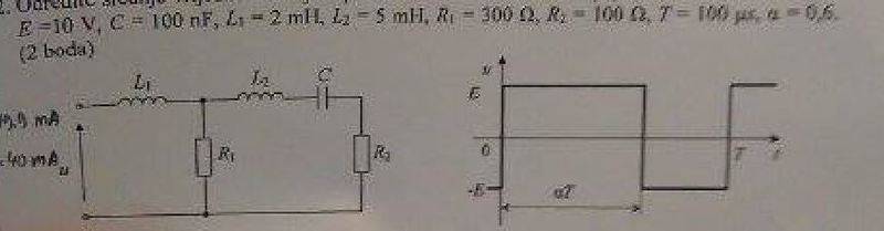

Find the average currents through resistors R1 and R2
I have a question , how do I analyse this circuit besides solving differential equations using laplace transform which takes too much time, what is really confusing me is the waveform of the voltage u(t) . Well current that goes through R2 is the same current that goes through the capacitor therefore average value should be zero , Ic(0) = IR2(0) = 0 A, also we know that average voltages are zero on the inductor UL(0) = 0 , so whole U(0) = UR1(0) , so IR1(0) 0 UR1(0) / R1 does this make sense?
( currents and voltages with zero in brackets represent avg values)

Yes it's periodically square wave , not sure whether it asks to find absolute values, it says find average value of the currents, therefore avg value can be negative , if that is what you meant.

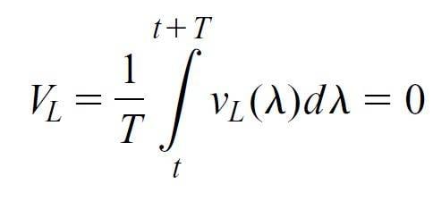

Average currents and voltages are very often calculated in power electronics, for devices like DC-DC converters and rectifiers.
The average inductor voltage is zero:
screenshot software
If this wasn't the case every period you would have more Vs in the inductor.

This was actually a first task in the exam this week from the power electronics course. I just simplified the task not bothering you with with numbers.
screengrab
As you can see from the picture it is a rectangular wave signal with duty-cycle ≠ 50%.
(notice different notation for duty cycle 'α')
α = D = duty cycle = 0.6

Yes picture is clarification from the context of the circuit in post #1. I figured out how to solve this circuit in my 1st post , just wasn't sure if it was correct way , needed your approval. Asked a friend of mine , he agreed with my solution
Ic(0) = IR1(0) = 0 and U(0) = UR1(0) -----> IR1(0) = UR1(0) / R1
if you put numbers in:
U(0) = 10 * 0.6 - 10 * (1-0.6 ) = 2 V
IR1(0) = UR1(0) / R1 = 2 / 300 = 6.67 mA
