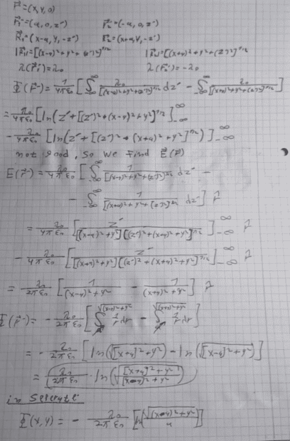

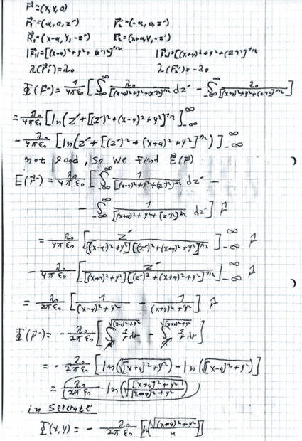

I can't really see what you have written here, the resolution is too low. I will say that it is highly probable that you are making incorrect statements about the potential approach not being good.

Oh sorry, I will try to upload in good resolution, I will edit. ( My camera has problem at boundarys, the focus it bad, It is the best I could do )
But anyway, the solution is good.
About potential approach not being good, I had lot of problems there as you saw, it was impossible to me without doing electric field as kuruman said sadly. since I had ##+-infinity## at boundarys.
But anyway, now I know how to do the solution, so if I will see it in the future, it is now easy :)
Thanks to all of you, sorry for being "block head" as not wanting to use Gauss and such.

Still impossible to see what is written in text. This is how it looks:
For the future, please learn to use the LaTeX features of the forum.
physics1000 said:
About potential approach not being good, I had lot of problems there as you saw, it was impossible to me without doing electric field as kuruman said sadly. since I had +−infinity at boundarys.
As I told you several times, this was never a problem. Your problem was not shifting the potential to keep the zero level at the correct place. The point-particle potential you should be using was
G(\vec r, \vec r') = \frac{1}{4\pi \epsilon_0} \left( \frac{1}{|\vec r - \vec r'|} - \frac{1}{|\vec r'|}\right)
This has the same derivatives with respect to the unprimed coordinates as the typical point-particle potential (the first term) but is constructed to have the zero-level at the origin ##\vec r = 0##. The integral will converge without issues.
Alternatively you can just take the integral from ##-Z## to ##Z##, subtract the potential at the origin after, and then let ##Z \to \infty##.

Oh sorry, I know how to latex, I did it before at this post.
I will write it now:
##\vec{r\:\:}=\left(x,\:y,\:z\right)\:##
##\:\vec{r'\:\:}=\left(a,\:0,\:z'\right)##
##\vec{R_{\:\:}}\:=\:\left(x-a,\:y,\:-z'\right)##
##\:\left|\vec{R\:}\right|=\:\left(\left(x-a\right)^2+y^2+\left(z'\right)^2\right)^{\frac{1}{2}}##
##\lambda \left(\vec{r'\:}\right)=\lambda _0##
##\Phi \left(\vec{r'\:}\right)=\frac{1}{4\pi \epsilon _0}\int _{-\infty }^{+\infty }\frac{\lambda _0}{\left(\left(x-a\right)^2+y^2+\left(z'\right)^2\right)^{\frac{1}{2}}}\:dz'##
Not Good, so we find Electric field
##\:\:\:\:\:\vec{E}\left(\vec{r\:}\right)=\frac{\lambda _0}{4\pi \epsilon _0}\int _{-\infty \:}^{+\infty \:}\frac{\lambda \:_0}{\left(\left(x-a\right)^2+y^2+\left(z'\right)^2\right)^{\frac{3}{2}}}\:dz'\:=\frac{\lambda _0}{2\pi \epsilon _0}\left[\frac{1}{\left(x-a\right)^2+y^2}\right]\hat{r\:}##
And then
##\Phi \left(\vec{r'\:}\right)=-\frac{\lambda _0}{2\pi \epsilon _0}\int _a^{\sqrt{\left(x-a\right)^2+y^2}}\frac{1}{r}dr\:=\frac{-\lambda _0}{2\pi \epsilon _0}ln\left(\frac{\sqrt{\left(x-a\right)^2+y^2}}{a}\right)##
And about your idea, I dont really understand how it shifted it to zero? and what it means by that.
