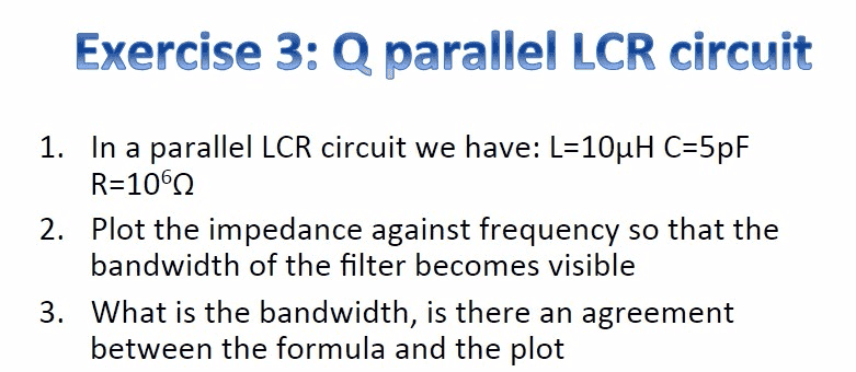

ItsTheSebbe
The attempt at a solution
Constructing the total impedance of the circuit as follows,
$$\frac{1}{Z_T}=\frac{1}{Z_R}+\frac{1}{Z_C}+\frac{1}{Z_L}$$
where $Z_R=R$, $Z_C=-j\frac{1}{\omega C}$ and $Z_L=j\omega L$.
$$\frac{1}{Z_T}=\frac{1}{R}+j\omega C+\frac{1}{j\omega L}$$
solving for $Z_T$ gives us,
$$Z_T=\frac{Rj\omega L}{j\omega L-RCL\omega^2+R}$$
where $\omega=2\pi f$
$$Z_T=\frac{2\pi fRLj }{2\pi fLj-RCL(2\pi f)^2+R}$$
Plotting this function over the frequencies, whilst $L=10\ \mu H$, $C=5\ pF$ and $R=10^6\ \Omega
From here, I created the following MATLAB code to find:
- The magnitude of the impedance (Z_Mag) for a range of frequencies.
- Finding the maximum of Z_mag and it's corresponding frequency.
- finding the -3db points and the frequencies that correspond to these points.
- taking the difference of said frequencies in order to calculate the bandwidth.

Now when I vary the N (number of frequency samples), the bandwidth I find seems to change quite drastically. Ideally, I would expect the bandwidth to asymptotically approach some value with a greater accuracy for a greater N.
I have been trying to found out what I did wrong for some time now, does anyone know where I went wrong? Thanks!

I found an error in my program, which solved the problem.
