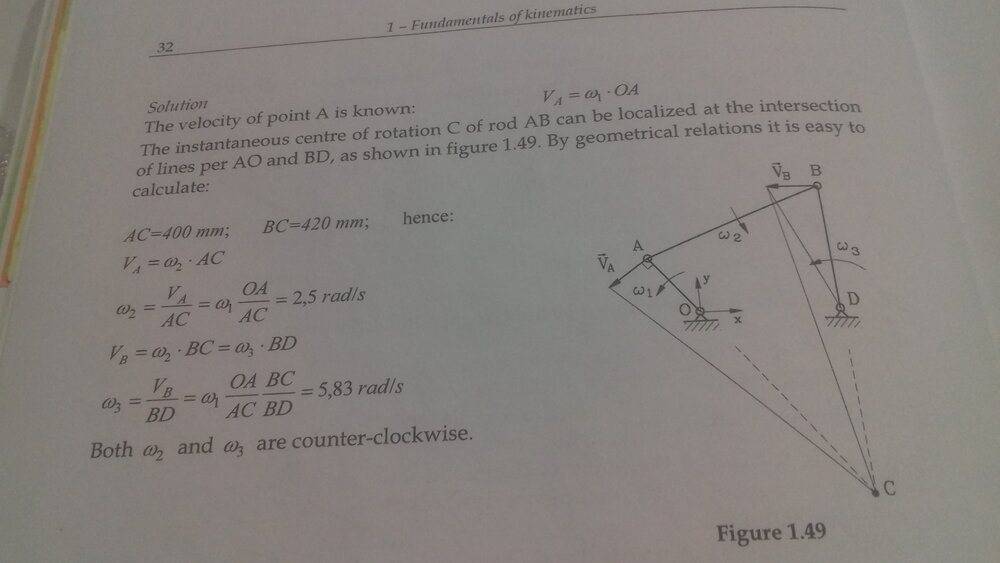

I have a problem in finding the value of AC and BC, I couldn't figure it out?
many thanks in advance!
I don't think your relevant equation is going to help you there. Don't you have anything else in your toolbox ? Something geometrical or trigonometrical, perhaps ? Keep searching !

thanks a lot for your reply!
it's certainly something geometric but I couldn't figure it out

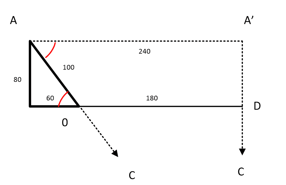

I made a drawing and needed the coordinates of D. From the picture it isn't all that clear but I guess you can check in your book that (180,0) isn't all that bad...
And what about B :wink: ?
With that settled, things are obvious, right ?
not really :wideeyed: can you please be more explicit?
My post was actually a question:
Can you confirm that O and D are at the same y-coordinate in your book ? And B and D at the same x ?

So what is the perpendicular distance from A to BD ?
60+180=240
So do you now see the 3,4,5 and 5,12,13 rectangular triangles ?

so let's consider A' as the projection of A on BD
you are talking about the triangles AA'B and AA'C
we know all the values of the triangle AA'B but we only know one value the length AA' for the triangle AA'C
but I still can't see how can we apply that phytagora theorem (except from finding BA')
thanks a lot!
AD is the hypothenuse of a 3,4,5 triangle. So AA'C is also a 3,4,5 triangle :wink:

$$3^2+4^2=5^2$$is known, right ?
Since the two red angles are the same, AA' is the 3 of 3,4,5 in AA'C

I re-did it. Should be a picture now. But you have your own picture too, right ?

thanks a million! it's clear now
