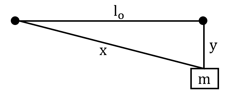

A wire of unstretched length ##l_o## is extended by a distance ##10^{-3}l_o## when a certain mass is hung from its bottom end. If this same wire is connected between two points, A and B, that are a distance ##l_o## apart on the same horizontal level, and the same mass is hung from the midpoint of the wire as shown, what is the depression y of the midpoint, and what is the tension of the wire?
https://imgur.com/niVACGg
Hook's Law:
##F=-kx##
I would assume that all the tension in the wire originates from the weight of the mass, and is equal to ##T=mg##, but that is incorrect.
Forming a right triangle with a hypothenuse denoted by ##x## and applying Pythagoras theorem:
\begin{cases}x^2=y^2+l_o^2 \\ x+y=l_o+\Delta l\end{cases}
Solving for ##y## I get:
$$y=\frac{0.01l_o⋅ 2.01}{2.02}≈0.01l_o$$
which is too incorrect.
The answers given by my textbook:
##y=l_o/20##
##T=5mg##
How can I arrive at those?
That is extremely confusing if your relevant equation is ##F=-kx##.
$$\begin{cases}x^2=y^2+l_o^2 \\ x+y=l_o+\Delta l\end{cases} $$
Do that again...

What on Earth is the ##x## in your 'other' equations ? (I know what it is in you relevant equation)
I still don't see where you relevant equation is put into action ...
Please explain your equation:
x=lo+Δl−y
You said in your original post that x is the hypotenuse. Perhaps you should draw the triangle of which x is the hypotenuse. Then explain what is lo, Δl, and y. Perhaps just draw it for yourself (if posting a photo would be a problem) and see if you do not see an error. Hint: if I am guessing right, you have 2 triangles. Edit: 2 right triangles.Remember, only right triangles have a hypotenuse.
What is lo?
kaspis245 said:
##x^2=y^2+l_o^2 ##, ##x+y=l_o+\Delta l##
The mass is suspended from the midpoint of the wire. Both of those equations are as though it is directly underneath one end of the wire.

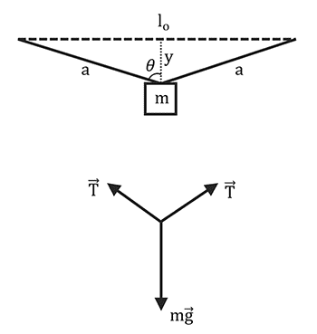

Your first diagram is a bit deceptive in that it shows the mass somewhat off centre. Can you see how to construct a right triangle with the mass positioned correctly?
Do I need to remind you of your relevant equation ##F= - kx## ? How's that in relation to your ##x## in the pictures ?
I still don't quite understand why the triangle I formed would be any different, but never mind that.
Assuming that the mass is at the midpoint of the wire and that the length of one side of the formed triangle is ##a##, these are the equations I got:
\begin{cases} a^2=y^2+l_o^2/4 \\ 2a=l_o+\Delta l \end{cases}
$$y=0.022l_o$$
Not quite the correct answer.
As mentioned before, ##x## in the pictures is not related to Hook's law - just a poor choice of variables.
Because ##l_0^2## is not the same as twice ##\left ({1\over 2} l_0\right )^2##, but more importantly: you can never make a horizontal force balance that way ! And you really need one ...
Now finally get rid of one of the ##x## to end your own confusion...

Those equations are now correct, but you have not explained how you get the value of y.
In post #1 you wrote T=mg. That is not correct. In your corrected diagram, what are the forces acting at the point where the mass is suspended from the wire?
Assuming that the tension in each piece of the wire is ##Tcosθ##, then the equilibrium equation at the point where the mass is suspended is:
$$2Tcosθ=mg$$$$T=\frac{mga}{2y}$$
when I take ##y=l_o/20## and solve for ##T##, I get the correct answer ##T=5mg##. The only thing left is to find out how to arrive at ##y=l_o/20##.

What is the basis for such an assumption ? Make a free body diagram and clearly indicate what forces play a role.
I assume you mean the vertical component of the tension.
You know what the extension is when the mass hangs from the wire vertically. What equation does that give you for the elastic constant, k?

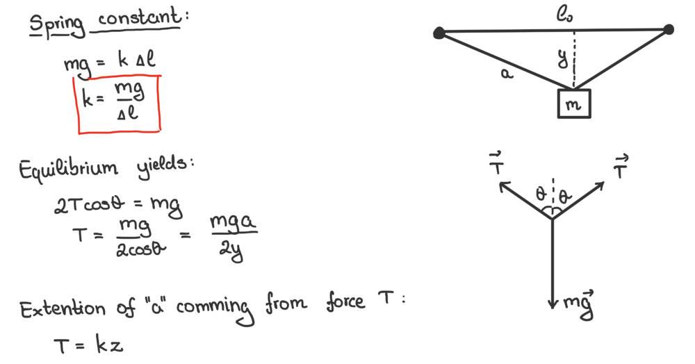

Starting from the beginning.
Step 1
Initially, when the mass is hung at the end of the string vertically, we have
$$mg=kx$$
Since the string extends by ##\Delta l=10^{-3}l_o##, we have
$$mg=k\Delta l\\⇒k=\frac{mg}{\Delta l}$$
Step 2
Next, from the diagrams above I can deduce, that the horizontal forces ##Tsinθ## of the system cancel out, while for the vertical ones we have
$$2Tcosθ=mg\\⇒2T\frac{y}{a}=mg$$
Step 3
Examining a single right triangle with a hypotenuse ##a##, I say that the tension ##T## in that part of the string causes an extension ##δ##. So the string of length ##a## extends by ##δ##
$$T=kδ.$$
Step 4
Lastly, I relate the original length of the string with the newly stretched one with the following equation
$$2a=l_o+2δ$$
Solution
Putting everything together I get a system of equations
\begin{cases} k=\frac{mg}{\Delta l} \\ 2T\frac{y}{a}=mg \\ T=kδ \\ 2a=l_o+2δ \end{cases}
which don't give me a solution. I could also put an additional equation using Pythagoras theorem ##a^2=y^2+\frac{l_o^2}{4}##, but that only complicates things. Could someone point out in which step did I make a mistake?

If I'm including the Pythagoras equation then the full system of equations is
\begin{cases} k=\frac{mg}{\Delta l} \\ 2T\frac{y}{a}=mg \\ T=kδ \\ 2a=l_o+2δ \\ a^2=y^2+\frac{l_o^2}{4}\end{cases}
Eliminating ##k## and ##T## reduces the system to
\begin{cases} 2yδ=a\Delta l \\ 2a=l_o+2δ \\ a^2=y^2+\frac{l_o^2}{4}\end{cases}
Next I eliminate δ
\begin{cases} (2a-l_o)y=a\Delta l \\ a^2=y^2+\frac{l_o^2}{4}\end{cases}
Finally I try to eliminate ##a## and get the following expression
$$\left(2\sqrt{y^2+\frac{l_o^2}{4}}-l_o\right) y=\sqrt{y^2+\frac{l_o^2}{4}}\Delta l$$
As I mentioned previously, I see no clear way to solve that for ##y##. If I attempt to make an approximation that ##y^2<<\frac{l_o^2}{4}##, this gives zero on one side of the equation:
$$\left(2\frac{l_o}{2}-l_o\right)y=\frac{l_o}{2}\Delta l$$
Any other ideas?

Ok, so once again our final system of equations is
Expressing ##a## from the first equation
$$a=\frac{l_oy}{2y-\Delta l}$$
Putting that into the second one
$$\frac{l_o^2y^2}{(2y-\Delta l)^2}=y^2+\frac{l_o^2}{4}$$
$$l_o^2y^2=\left(y^2+\frac{l_o^2}{4}\right)(4y^2-4y\Delta l+(\Delta l)^2)$$
At this point I don't know how to move forward - taking ##\Delta l≈0## or ##(\Delta l)^2≈0## doesn't get me anywhere.

Certainly discard the ##(\Delta l)^2## term.
Cancelling a factor y, you should have a y2 term, a y3 term, and and a y0 term. From this, you can see that y is somewhat small compared with l0, allowing you to try discarding the y2 term. We can check later whether that is valid.
(Alternatively, use the formula for solving a cubic.)
Discarding the ##(\Delta l)^2## term and expanding the right side of the equation
$$l_o^2y^2=4y^2-4y^3\Delta l+y^2l_o^2-yl_o^2\Delta l$$$$4y^3-4y^2\Delta l-l_o^2\Delta l=0$$
I don't see why I should discard the ##y^2## term and leave ##y^3##.
I tried solving the cubic equation with Wolfram Alpha, there are no solutions that are even close to the correct one. I'll remind you that the solution given by the textbook is ##y=\frac{l_o}{20}##.
Because the y2 term has a factor ##\Delta l##, which makes it the smallest of the three terms.
I don't get the given answer, but it isn't that far off... ##\frac {l_0}{10*2^\frac 23}##.
If I eliminate the ##y^2## term, the equation $$4y^3-l_o^2\Delta l=0$$ is much closer to a solution of ##y=\frac{l_o}{16}## than to ##y=\frac{l_o}{20}## - that's a 20% difference. I don't see why they would choose ##\frac{l_o}{20}##.

Given for spring constant: k=1000mg/L0, (2)
From Hook's Law, and using (1) and (2):
k(L-L0)=T, that is 2000mgy2/L02=T. (3)
From force balance: mg=2Tcos(θ). As cos(θ)=y/(L/2) mg=4Ty/L (4).
From (3) and (4), and taking L≈L0, the result is y=L0/20.
Likes haruspex
  • #31
ehild said:
You droppwd a "2" somewhere. I got the given result, ΔL=L0/20, with approximating L≈L0 where it was possible (Lis the stretched length):
Pythagoras: (L/2)2-(L0/2)2=y2 ----> (L-L0)(L+L0)=4y2
using L≈L0,
(L-L0)=2y2/L0. (1)
Thanks, I've found it.
Post #22 fourth equation should read ##2a=l_0+\delta##, not ##2a=l_0+2\delta##.
  • #32
I'm also confused as to where the factor of two comes into play. For my equations, I have:
$$[1] \qquad F_{net,y} = mg = 2Tsin(\theta) \approx 2Ttan(\theta) \Rightarrow T = \frac{mg}{2tan(\theta)}$$ where ##\theta## is the angle between the horizontal and and the wire.
$$[2] \qquad tan(\theta) = \frac{y}{\frac{l_0}{2}} = \frac{2y}{l_0}$$
$$[3] \qquad l'^2 = y^2 + (\frac{l_0}{2})^2 \ \Rightarrow l' \approx \frac{l_0}{2} + \frac{y^2}{l_0}$$ where I used the binomial expansion to expand the root term above
$$[4] \qquad T = k(l' - \frac{l_0}{2}) = \frac{mgy^2}{\delta l_0}$$
combining it all, I end up with:
$$y^3 = \frac{l_0^3}{4000}$$
and the only way I end up with the correct solution of ##y=\frac{l_0}{20}## is if in the 4th equation that ##T=2k(l' - \frac{l_0}{2})##. Is there any physical reason as to why that should be the case?
  • #33
Indeed there is.
The whole wire has relaxed length ##l_0## and is extended to length ##2l'##.
k is the constant for the wire as a whole. Half the wire would have twice the constant.
Likes magic
  • #34
Thank you haruspex! It completely slipped from me that ##k## depends just as much on the geometry of the wire as it does with the material.
