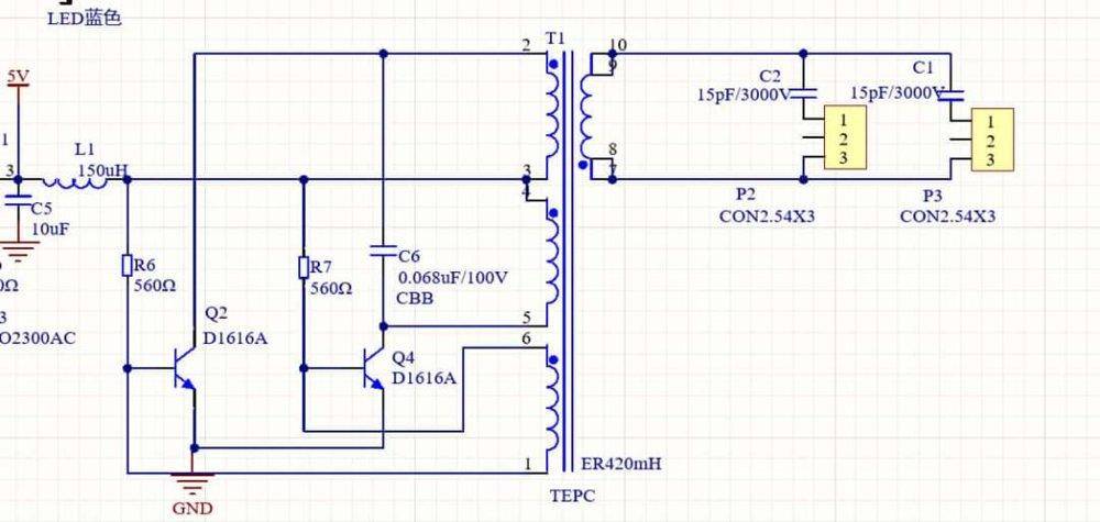

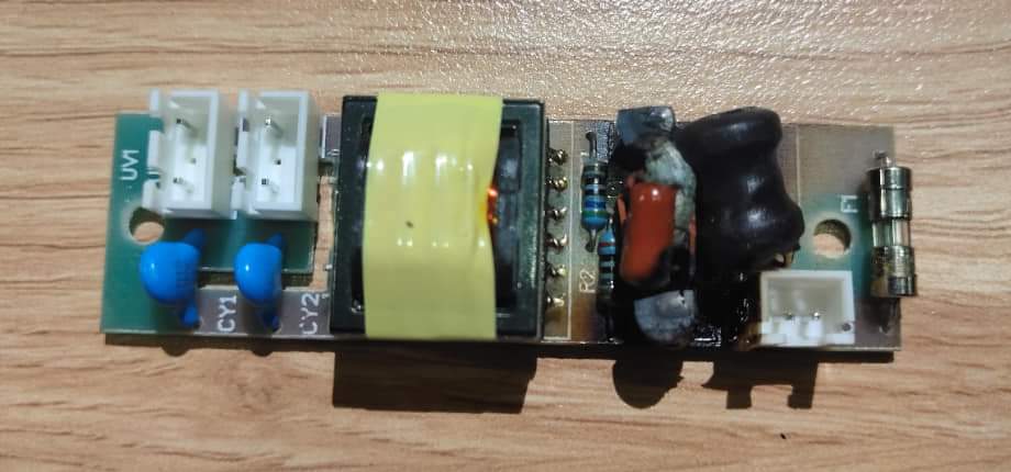

Guys this circuit and shematic is of UV lamp controller.. It burns sometime as shown in figure can someone tell the reason?

Is this a one time failure? From your description, 'sometimes it burns', does this mean it has happened with a replacement controller, too? Do you have UV lamp specifications you can let us see?

Several possibilities:
  • Load is too heavy (wrong lamps? high humidity?))
  • Running without a load
  • C6 bad
  • Transformer has shorted turn(s)
  • A resistor has changed value (looks like they have overheated, replace 'em)
  • Supply voltage is (occassionally?) too high
  • High ambient temperature
  • Bad design (parts under-rated for the use)
The above is roughly in order of probability. (unless it is a third-world design with a very low price; then the bad design is most likely. :wink:)
Likely a few more "maybe's."
From the looks of them, those transistors have failed shorted. Which could be temperature related (overload, shorted transformer, shorted C6) or from voltage spikes (running no-load, or open C6). Could also be a bad resistor.

@engnrshyckh -- The schematic looks a bit amateurish. Is this a home-brew circuit? Did you design it? If not, where did you get it and the schematic?
