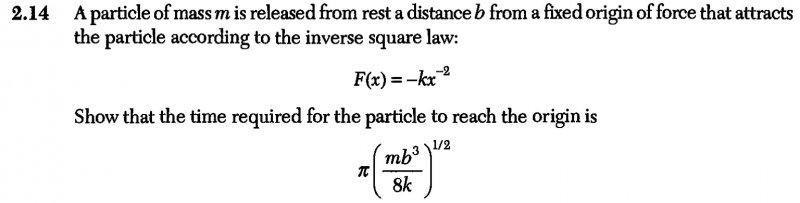

The problem, relevant equations, and my attempt at a solution are all shown on both attached images.
Not sure where the π and and extra (1/4)1/2 is coming from.
Also, I noticed that my final result, in the attemp at a solution should be t=(mb3/4k)1/2, no negative sign.
Your velocity calculation is wrong. That definite integral will give the velocity at the origin (which will be infinite), but for the next step you need the velocity at an arbitrary distance x.
Thanks for the quick reply, but not to seem to ignorant in relation to using definite integrals, why would the velocity be infinite at origin?

What did the indefinite integral look like? What happened when you applied the x=0 bound?

so obvious, it gets divided by zero; it Is undefined.
Thanks again
