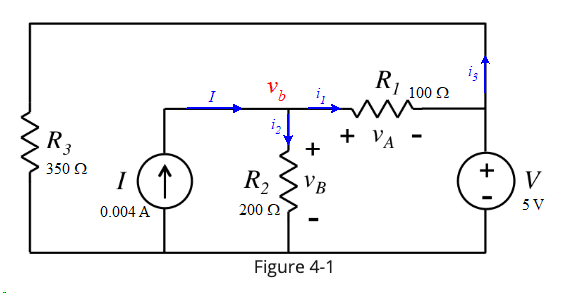

A linear circuit is shown in the figure.
The elements in this circuit have the following values: R = 100 Ohms, R2 = 200 Ohms, R3 = 350 Ohms, V = 5V, and I = 0.004 A.
1. Determine the potentials of drops v_a and v_b across resistors R1 and R2 respectively.
2. Now let us determine if the answers you came up with satisfy the laws of physics.
(a) What is the power (in Watts) dissipated in resistor R1?
(b) What is the power (in Watts) dissipated in resistor R2?
(c) What is the power (in Watts) dissipated in resistor R3?
(d) What is the power (in Watts) coming out of the voltage source V?
(e) What is the power (in Watts) coming out of the current source I?
KVL
KCL
V/I = R
From the circuit I have:
##-v_b + v_a + V = 0##
##v_b - V = v_a##
##i_1 = (v_b - V)/R_1##
##I + i_2 = i_1##
##(v_b - V)/R_1 = I + v_b/R_2##
From this last equation I get ##v_b = 10.8## and hence ##v_a = 5.8##.
However, apparently that is wrong. (And hence my answers to #2 were all wrong as well.) Why is that so? What might I be doing wrong

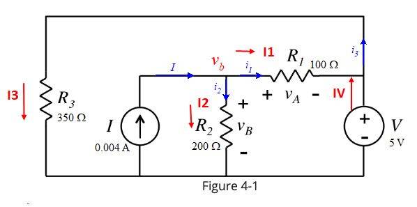

Could you mark up your circuit diagram with the currents you're working with, showing their assumed directions? I suspect that the issue you're having may have to do conflicting or inconsistent assumptions about current directions.
@gneill

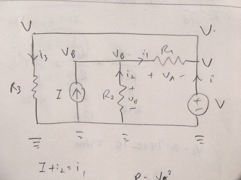

I also have this equation written down: ## i_1 + i = i_3##.
Okay! Take a look at how you're calculating ##i_2##. Note the assumed polarity of ##V_B## and the direction of ##i_2##.
Oh, should it actually be ##I + i1 + i2 = 0## (bc they all come into the node with potential ##v_b##)?
But I didn't really use this equation to get the voltages...
I believe that you used the equation:
## (v_b - V)/R_1 = I + v_b/R_2##
But ##v_b/R_2##, given the defined polarity of ##v_b##, describes a current flowing from the node through ##R_2## to ground, opposite of what you defined ##i_2##'s direction to be. So, change your equation to:
## (v_b - V)/R_1 = I - v_b/R_2##
and see what you get.
Quick followup. If I were to define the currents for the circuit, I'd first take note of the predefined polarities of the voltages across the resistors to make my current direction choices. That way my choices will be consistent with the given definitions that we have to live with:
The direction of ##i_3## is a no-brainer, since it's being driven by the 5 V source.
I did think i3 would be driven by the 5V source, but I was confused bc I thought that i3 would be different from the original current from the 5V source (which I labelled in my diagram as ##i##) due to the "addition" of the ##i_1## source at the first junction. Is that way of thinking wrong?
Nope. ##i_3## is a separate current from your ##i##. Labeling and analyzing are two different steps. Labeling sets your assumptions in place so that the analysis can proceed without logical contradictions creeping in.
Your ##i_1## and ##i## should indeed sum to ##i_3##. But it is (hopefully) obvious that ##i_3## can be calculated quite simply by dividing the 5V source voltage by ##R_3##.

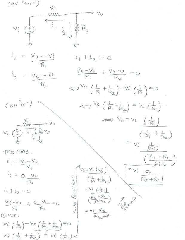

I hate bookkeeping too. It looks like you pretty much have your answer, but you might like this approach I posted on another thread (here).
Draw all of the current going the same direction and set it to zero. The negative sign will "correct" your answer in the final solution. Here's an example:
I later presented in the thread solving a simple voltage divider. The point of it was to show that the direction of the arrows didn't matter.
It's not to say that predefined directions are wrong (this is really the same thing), but to suggest make everything the same predefined direction so there's no need to draw diagrams or remember direction... just be consistent.
