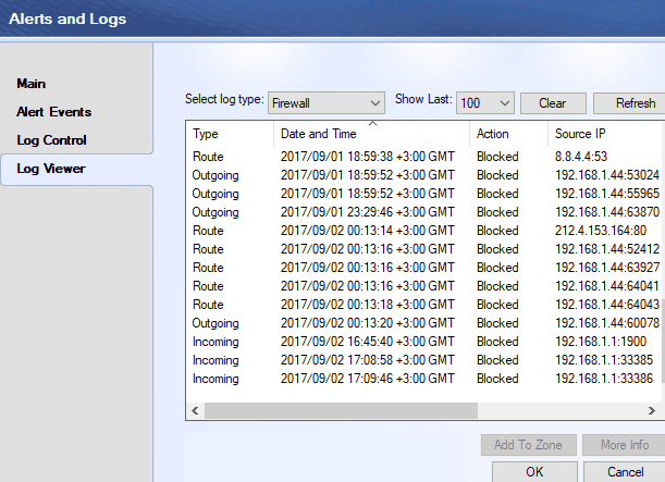

I have installed an antivirus. But one day I realized that somebody was controlling my PC. Then I installed a firewall. There are lots of attempts to my PC which are recoreded in the firewall. I am very confused why these are happening and who they are, how they can do this. Now some important performance issues has started. I do not know if I am secure. How can I completely be sure that my PC is secure? Can firewall stop all attempts. I did a full system scan. There is no virus or other malevolent programs. I use a wlan and how can I be sure if somebody is in my wlan? How can I close dangerous ports through which they can access to my PC?
What are those "route", "incoming", "outgoing" in the firewall?
Thank you.
Addresses that start with 192.168.1 are addresses within your own LAN and usually are nothing more than internal software communication. From the limited image, it looks like there are two main computers on your network - one at 192.168.1.1 and one at 192.168.1.44. I suspect that 1.1 is your computer but that's just a guess. Incoming and outgoing traffic within the network is generally harmless. The 30,000 and 60,000 range port numbers are a little odd but it's hard to know without more info.
Likes jedishrfu, fluidistic and mech-eng
http://whatismyipaddress.com/ip/8.8.4.4 is a Google address so that looks harmless. The http://whatismyipaddress.com/ip/212.4.153.164 address is a server in the Czech Republic and port 80 means that you're connected through a web browser so it looks like you were viewing a page at a site hosted in that country when you took the screenshot.
Likes WWGD, jedishrfu and fluidistic

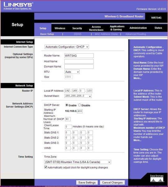

Tom.G said:
Once the router screen shows up in the browser...
It might look something like this... my old one.
As Tom.G said...
It is possible to disable connectivity between the router and all of your devices. If this happens you will have to find in the documentation how to reset the router to "Factory Defaults" and then start over and reconfigure your network.
I did... just once, though. [COLOR=#black]..[/COLOR] lol
Unfortunately I can only guess what's happening in your logs without the "Destination IP" column being in view, it's like trying to understand a phone conversation by hearing one side of the conversation. I'll try to address the different questions you posed separately.
You can never really be sure a networked computer is secure, the best you can do is take precautions, the most important being to backup you data to an external disk and store it somewhere else safe. See these recommendations from US-CERT for more internet security best practices.
A firewall will stop all attempts that are not configured to be allowed. I suggest NOT changing the default rules if you don't have a solid grasp on network routing and packet filtering.
You should be able to see all connected Wi-Fi devices when you log into your access point or router.
You have done this by installing a software firewall.
ZoneAlarm doesn't define what the connection type "Route" means in their documentation, but I can infer it to mean connections your computer recently initiated, but are no longer valid for various reasons.
"Incoming" means connections initiated by another system to your computer.
"Outgoing" means connections initiated by your computer to another system.
