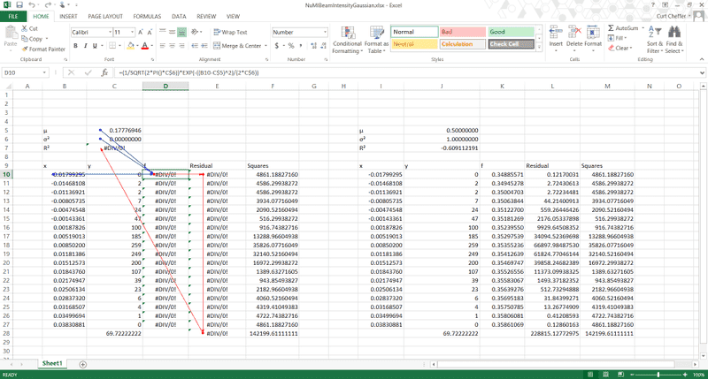

I've figured out a bit more. I'm getting a division by zero error because my sigma² is somehow becoming zero when I try to optimize the data for the Gaussian fit. On the left is the data after being optimized, and on the right is all of the original data prior to optimization. I traced the error out and it's because the sigma² became zero, which doesn't make sense, because it definitely should not be zero as far as I can tell. I even tried bringing it out to 18 decimal places and it was still just zero.
Anyone have any other thoughts on this?

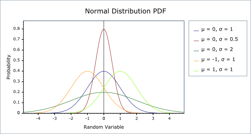

I've taken a look at your data and the values of μ and σ you are using for your trial Gaussian fit.
It occurs to me that your starting values for μ and σ lie outside the range of the x values for your sample data set. The μ value represents the mean value of x, i.e. where the Gaussian curve's peak is located. This value must lie somewhere between x = -0.01799295 and x = 0.03830881. Similarly, the value of σ controls if the Gaussian curve ir relatively broad or narrow. For a typical Gaussian curve, a distance of 3σ on each side of x = μ should encompass at least 99% of the area under the Gaussian curve, so if you took 6σ = 0.03830881 - (-0.01799295) = 0.05630176, then σ ≈ 0.009383627. I would try these estimates of μ and σ when starting the optimization process. Some scaling of the y-values will probably be required as well.
This diagram shows how a Gaussian curve changes with different values of μ and σ:
Likes QuantumCurt
