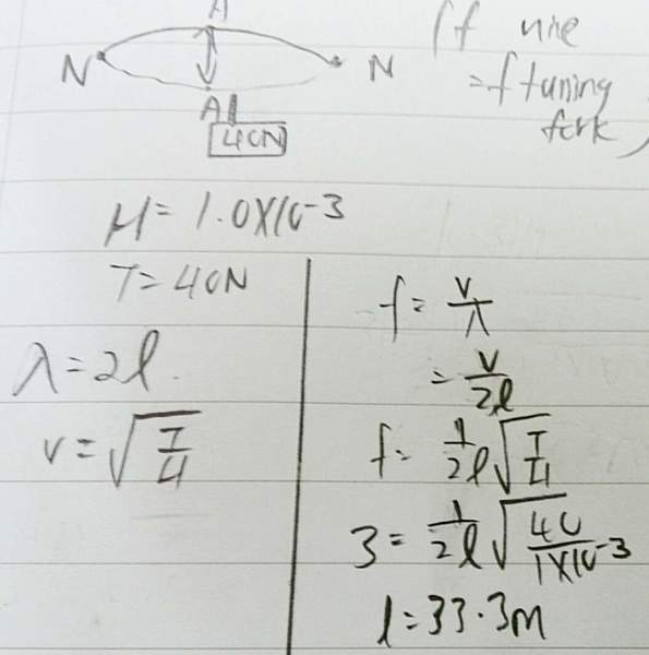

the working is in the second photo

I didn't see any discontinuity. Maybe the OP corrected the image?
EDIT: NM I see your point. The wording is horrible. The problem is not fully stated no matter how you rearrange the given data. The tuning fork frequency is obviously needed. The 3 Hz is a beat, not the tuning fork frequency. Etc.

why I couldn't hear 3hz tuning fork?
The lowest frequency that humans can hear is about 20Hz.
You can see something vibrating at 3Hz if the amplitude is big enough. But a "tuning fork" that vibrated at 3 Hz would be about 1m long, which is nonsense.
