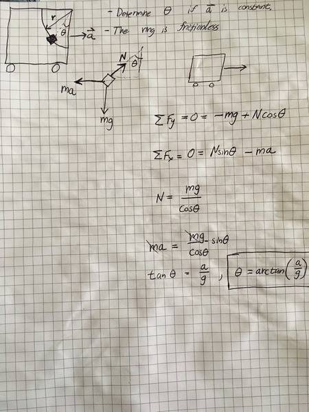

A box is sliding with constant acceleration a to the right. Inside the box there is a quarter of a circle upon which a frictionless ring can slide. Find the angle theta in terms of the other given variables.
Picture in solution
F=ma, etc. basic stuff
Pretty sure I did something wrong as I didn't even use "r".
Looks right to me.
Likes Feodalherren

Thanks for the quick response. They just put that "r" on there to throw me off huh?
I'm not sure if it was to throw you off - possibly. But for a given acceleration, the angle has to be the same, regardless of the radius.
Likes Feodalherren
But only in case there is no friction, such as here, correct? Because my intuition tells me it shouldn't be the same but I feel like that is because there would be far more friction if r was larger. Just want to check my logic here.
The angle is independent of radius when there is no friction. What would happen if there was friction, I'm not sure.
If you use the reference frame of the inside of the box, then there is a fictitious force to the left (proportional to the mass of the ring). This will slide the ring up a slope unless and until the gravity down the slope equals the fictitious force up the slope. As both of these forces are independent or ##r##, then so is the angle.
Friction would also be proportional to the mass and change with the angle, and again be independent of ##r##.
It shouldn't be too hard to add a coefficient of friction and see what happens.

Hmm. The way I see it, the distance that the ring must travel to reach the same angle increases with theta, that ought to mean that more energy is lost to friction but then again it's not a closed system.
Yes, exactly, it's not a closed system, so the external force needed to keep the constant acceleration will vary depending on what's going on inside the box (at least initially).
If you found the original problem easy enough, you ought to try adding friction. There's no pressure, though!

I think I might try that this weekend. It sounds fairly trivial, wouldn't it just be the the coefficient of friction multiplied by the normal force acting in a direction tangential to point of contact between the ring and the slider facing the down and to the right?
How do you know which way friction will act?
Friction always acts counter to the direction of movement, no?
It acts to oppose relative lateral motion of the surfaces in contact. That may be actual motion (kinetic) or potential motion (static).
So which way is the potential motion?
If you look at the original problem, you have calculated the angle at which the forces are balanced. But, at this point the ring will still be moving up the circle. The ring, therefore, will oscillate about this equilibrium point.
If you have friction, you can still calculate the first equlibrium point. Again, at this point, the ring will be moving upwards. Then, you might think about what happens to the ring after it moves past the equilibrium point.
Alternatively, you could think about what would happen if the ring was held at the top of the circle and then released.
I must admit, I wasn't thinking as deeply as @haruspex when I suggested adding friction. I was only thinking about the first equilibrium point.
Perhaps we've got you in a bit deep now!
