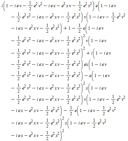

Alright, If I do that I get
(1+i*e*v-e^2*v^2/2 +i*ex-e^2*x*v-e^2*x^2/2)(1-i*e*v-e^2*v^2/2-i*e*x-e^2*v*x-e^2*x^2/2)
then expanding that leads to many terms
which doesn't lead to the correct answer, perhaps I am making an algebraic mistake
Orodruin said:
Dont let wolfram do it for you, just multiply the terms together and keep only terms up to order two in epsilon.
Go order by order. First check that all the linear terms cancel.
