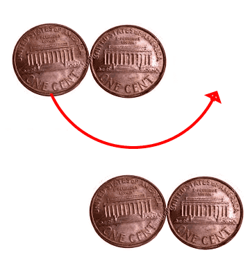

Gear Rotation puzzle is confusing 50:10 GR but 6 rotations
In summary, the penny on the left has gone halfway around the penny on the right. The angle of rotation through its own rotational axis was 180 degrees.

A gear A has 50 teeth and another B has 10 teeth, how many times does the small gear rotate around the big one? I thought 5 but its 6! Note: The gear is curved like 360 degrees.

How many times would it rotate going around if they had the same number of teeth?

Will it?
How many times will it rotate if it has 200000000000000 teeth and goes around a smaller gear with 10 teeth?

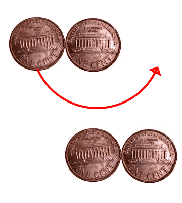

Try it.
The penny on the left has gone halfway around the penny on the right.
What angle of rotation through its own rotational axis did it experience?

Okay, I just tried the experiment with 2 one cent coins and found that thought there were no teeth to simulate it perfectly, the driver coin took almost exactly 2 rotations...

DaveC426913 said:
Try it.
Think, I see the point...Thank you!
I presume your answer was intended to address my post #6 about pennies, not sshanker's opening post #1.
Yes, the penny on the left has gone halfway around the penny on the right. That was a given.
The question was: what angle of rotation has the left penny undergone? (i.e. it starts with its face oriented upright - with text legible - but what orientation is its face when it ends? What angle has it rotated though? 90? 180? 360?) (Hint: the diagram in post 6 shows you the answer.)
One thing to notice about this exercise it’s that the gear needs to be pointing “upward”, not from the big gear reference, but from the initial position reference. That’s how I could get it.
