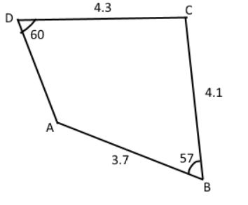

The problem
a) find the length of AD in the figure
b) Why are there two solutions in a) and what solution fits the figure?
Figure

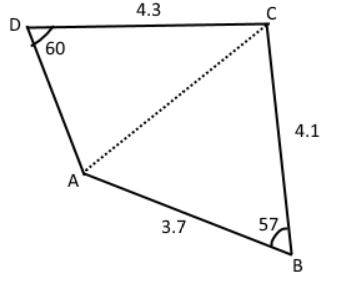

The attempt
I started with drawing a "help line" in the figure.
The cosine formula for AC with respect to triangles ADC and CBA gives us two equations:
## AC^2 = 4.1^2 + 3.7^2 - 2 \cdot 3.7 \cdot 4.1 \cdot cos(57) ##
and
## AC^2 = 4.3^2 + x^2 - 2 \cdot 4.3 \cdot x \cdot cos(60) ##
Setting these two equal to each other gives a polynomial of the 2nd degree that has two roots ## x_1=2.47886 ## and ## x_2=1.82114 ##. (These solutions are correct)
I am stuck at b). I have no idea how to continue.

What are all the angles that result from each solution?
Is the given drawing close to being drawn to scale?

No, the drawing is not drawn to scale. Should I calculate the all the possible angles in the figure?
Rectifier said:
... Should I calculate the all the possible angles in the figure?
That could help, especially for the portion above the "help line".

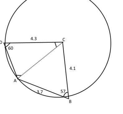

This may be obvious to you, but if you draw a circle centered at C with radius AC, the source of the two solutions and the answer to b) become clear.
Likes Rectifier
What do you mean by "the source of two solutions"? I am bad at english :,(
I mean it graphically shows the reason why there are two solutions, and why one of them matches the original sketch and the other one doesn't.
Likes Rectifier
Is this drawing correct?
Not sure how the corners D and B should be placed on the circle.
I am not sure how to see that there are two solutions now... :,(
B is not relevant.
Yeah, the drawing is so out of scale, it makes it hard. If it were to scale (I suggest you redraw it), the circle will cross AD much closer to A and then moving A to this new point is the second answer. The first answer has angle DAC as an acute angle and matches the original sketch. The second answer has angle DAC as an obtuse angle and so does not match.

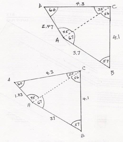

we can take the points A, B C to be fixed, as triangle ABC is fully specified.
Consider what happens to the angle ##\angle ADC## if we allow it to vary (rather than fixing it at 60 deg) as angle ##\angle ACD## varies from 0 to 180 degrees, keeping the length of CD fixed at 4.3. CD is longer than AC so at ##\angle ACD=0## D will be on the extension of AC at a point further from C than A. Call that point D0. So ##\angle ADC=0##.
When ##\angle ACD=## 180 degrees D will be on the extension of AC at a point further from A than C. Call that point D180. So ##\angle ADC=0## again.
##\angle ADC=0## will be at a maximum when triangle ADC is isosceles, which is when the projection of D onto AC is at the midpoint of AC. And that maximum will be more than 60 degrees. Call the place where D is in that case Disos.
So the angle must pass through 60 degrees twice, once as D rotates from D0 towards Disos, and once again as D rotates from Disos towards D180. Those two points are the two solutions.
From the diagram, which I haven't checked for scale, it looks like the solution drawn is the first of the two solutions. IN the other solution ##\angle ACD## will be of the order of 140 degrees.
For better or worse, here are my two solutions, drawn to scale. You can faintly see an arc of the circle through A I referred to above.
