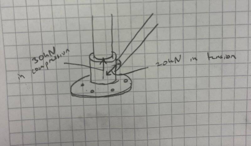

I changed the baseplate geometry to a circle and not a square. I cant use 8 bolts? Why only 2-3?
You should use 8 bolts, but depending on the direction of the boom load, most will not be doing any real work.
The boom is a lever arm trying to overturn the base.

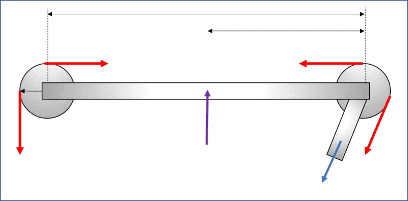

I didnt understand the part with the boom load, where is that? Could you maybe draw it? Its not the force coming from the lift?

I got forces here aswell, do i have to do calculation based on them someway to get the forces acting on each bolt maybe and not only the lift load?

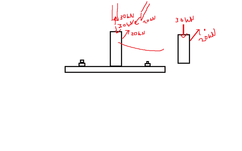

The load hanging on the hook is not above the centre of the base.
Extend the line of the rope downwards, then measure the distance from the vertical axis of the base to that line. That is the radius to the load. That is effectively the boom of the crane.
The moment of the load, at that radius, is countered by the base. Some base forces are downwards, but on the side furthest from the load, the forces are upwards. The two or three bolts on that side are under tension.

I have no idea what is fixed and what is moving there.
You must draw and label a better diagram.

The load creates a moment ## \circlearrowleft## about the anchor.
The bolts farther away from the axis of rotation ( ##\color{red}+##) tend to carry more load. Assuming only 2 of the farthest bolts balance the moment builds in a factor of safety.
You balance the moment from the bolts about the axis of rotation against your moment load. Then you use the proof strength of a desired grade bolt and calculated tensile load to calculate bolt cross-section.

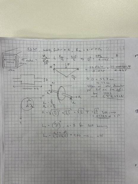

salamikorv said:
Another thing, this is for the bearing, i got these calculations and i ended up with 0,7 revolutions....
And the text part is saying "choosing a ball bearing diameter of 35mm from SKF, bearing 16003 with C = 6,37kN" What should i do to fix this and get atleast a million revolutions or higher.View attachment 325008
What is going on in this calculation?
Please take a moment to learn how to use Latex to format your calculations so we can clearly see them. These grainy images of chicken scratch are annoying for someone trying to help you to interpret.
1) Why are you cutting the bearing load in each direction in half? Are there two bearings in each sheave?
2) For the ##L_{10}## life the units are millions of revolutions. I tried to point that out, it doesn't appear that it has sunk in.

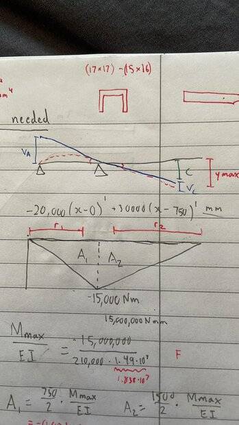

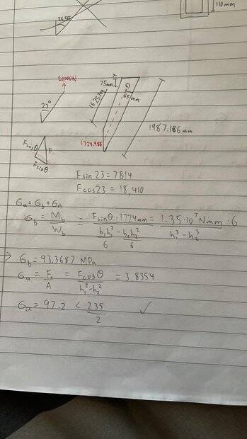

Sorry for the late reply, theres only bending on that point, 15000Nm. So as you can see, the 20kN is in tension and then theres 30kN for the beam in the middle thats 30kN in compression. Do i use those to calculate the tension on each bolt or?
  • #45
salamikorv said:
Sorry for the late reply, theres only bending on that point, 15000Nm. So as you can see, the 20kN is in tension and then theres 30kN for the beam in the middle thats 30kN in compression. Do i use those to calculate the tension on each bolt or?View attachment 325315
View attachment 325310View attachment 325311
Where is your free body diagram of the beam?

My mate is responsible for the calculations of the beam, and he got that, so what i have for the bottomplate is this
  • #47
salamikorv said:
My mate is responsible for the calculations of the beam, and he got that, so what i have for the bottomplate is thisView attachment 325317
Well, are you not able to do a FBD of the beam? It's always a good idea to check each other, and in this case I think it probably a really good idea.

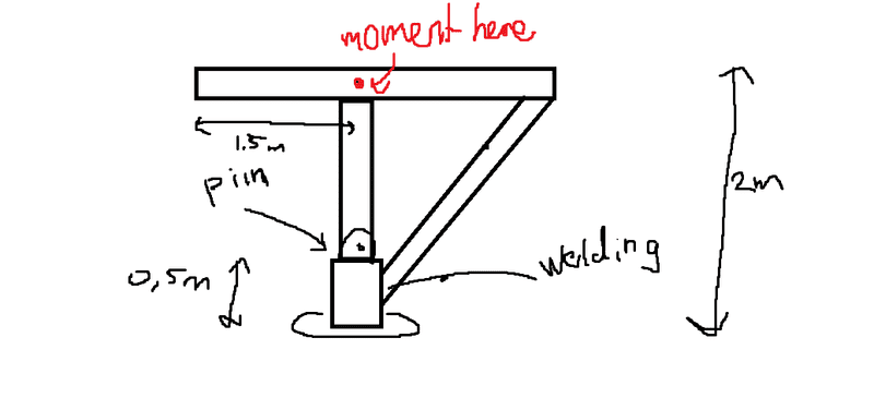

1.5m to the left, i mean thats the length from the left end of the beam to the point where you drew the upward force, and 0.75m is the length thats left
  • #60
salamikorv said:
1.5m to the left and 0.75m to the right
Explain how its in static equilibrium with an unbalanced horizontal force component from the support and the tension on the pulley?
  • #61
The beams are in static equilibrium since they are in rest state but yeah i guess with the pulleys its not in equilibrium once it starts to lift, when we stop the winch then its in static equilibrium.

The forces in the horizontal direction are unbalanced. The beam is not in static equilibrium with the loading your supervisors told you was correct.
salamikorv said:
Why cant you just assume the forces is right i dont really get this.
?? Do you wan't to find the actual loading on your mounting bracket?

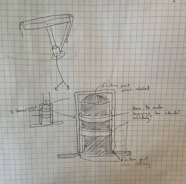

I have this crane that has to be able to lift a weight of maximum 1000kg. Its a type of a manual winch crane thats going to be able to rotate. I need help with the rotating part, i want to determine the bearings inside this rotating part and im thinking to use 2 bearings in there but im not sure if you can use welding on the edge of the bearings and make it stuck? And how i should determine them.
  • #68
@erobz alright fine, we can re-do it then.
  • #69
The bearing system will need to support both axial and radial loads. Why do you have four different bearing surfaces? Why are the two "bearings" so close together? What experience do you have in objects that weigh a ton? Perhaps you can work with someone locally.
