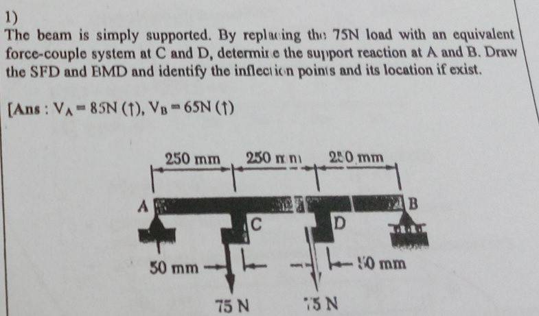

I gt VA and VB = 85 N and 65 N respectively ... but , my bending moment diagram doesn't return to 0 ... Is there something wrong with the question ?
I found that if i didnt include both the moment of 75(0.05) = 3.75Nm , the bending moment graph return to 0 perfectly ...

You have the bending moment suddenly diminishing at 200mm. The beam does not "know" the load is beneath that point. What it feels is the load and torque at the 250mm point.

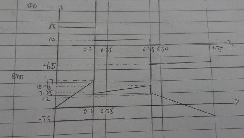

here's my sketch of BMD and SFD , are they correct ? For the BMD , i do in 2 ways , which are upper part of graph as positive and lower part of graph as negative ...

Yes, that looks better.

why when i calculate the moment about A , it's 75(0.2) + 75(0.45) -VB(0.75) = 0
VB = 65N , VA = 85N
Here's my ans which satisified the ans given , is my concept and equation correct ?
You ssaid that the beam will only feel the load and moment about C and D , so i am not sure about my ans

I think your difficulty is conceptual, so I'll describe a simpler example. Consider first a rod under tension T. At each point in the rod there is a force T pulling on it on one side balanced by an equal and opposite force on the other. But the stress at that point is the magnitude of these forces.
Now consider a horizontal 2m beam AB, midpoint C.
At the left (A) there is a 1N force acting down. At the right, a 1N force acting up. At C, a 2Nm torque clockwise.
The beam is therefore in equilibrium. If we look at any point on the beam, the sum of torques due to applied torques and forces on one side is equal and opposite to the sum on the other side. As for the rod, the torsional stress at the point is the magnitude of these opposing torque sums.
Perhaps the torque at C comes from some L-shaped descender attached there. Let's say it descends .5m, then goes off to the right for 4m to point D, where there is a downward force of .5 N. That provides the 2Nm torque. But the beam itself does not care how that torque is generated. It could have been 10m to point D and a force there of .2N, it makes no difference to the stresses at points along the beam.

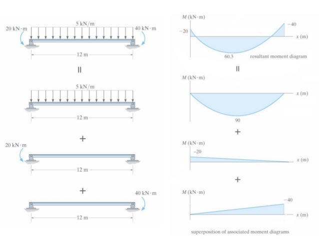

On the graph, positive should always be upwards.
Likes chetzread
is it a must that positive should always be upwards ?
I was going to say I've never seen a case where it isn't, but then I found this example in an image search. It seems like a recipe for confusion.
