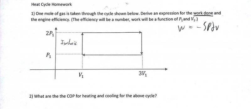

W=-∫PdV
ε=W/Q
PV=nRT
COP=Q/W
Using the first equation for work, I got W=-nrT*ln(3V1/V1) but I don't think that is right. Is this the wrong formula to use for this problem? My answer should be in terms of P1 and V1.
That is not the correct integration of PdV for the process shown in the figure.
What equation can I use to find the work then?
You can use the integral of PdV. Just do it in a way that is consistent with what you see in the diagram.
I just took the area of the rectangle. So W=2P1V1. I got an efficiency of 17% with that.
