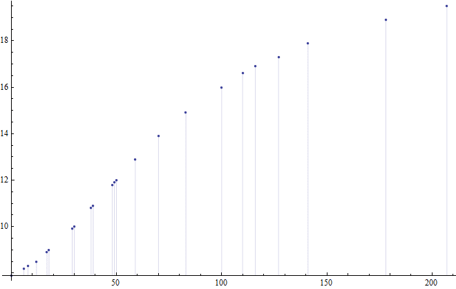

I am a homebrewer and built an insulated box for fermentation.
The container has walls of 5cm polystyrene (EPS), 2cm polystyrene(XPS) and 6mm plywood.
The container outer dimensions are height: 72cm(23.3inches), width and length 60cm(23.6 inches).
Inner height: 56cm(22 inches), width and depth 45cm(17.7 inches)
I took it outside where it was about 7C(44.6F) and left it there to cool it down. Then put the lid on and the temperature controller thermometer in and brought it inside where the ambient temperature was 22-23C (71.7-73.4F). I took notes how the temperature changed over time inside the box. Time units are in minutes. I didn't wait until it got to ambient, but it got rather close.
Sample data points:

The graph with full collected data and Celsius values:
How can I determine the amount of Watts seeping into my box for any temperature difference? The answer I am trying to get is something like: for a temperature difference of 7C, the box receives 12W/h. Or anything that gives me more-or-less accurate wattage in any form.

The basic equation is going to be:
[tex]WC_p\frac{dT}{dt}= \frac{(T_0-T)}{R}=Q[/tex]
where T is the temperature of the gas in the box, T0 is the outside temperature, t is time, W is the mass of gas in the box, Cp is the heat capacity of the gas, and R is the lumped resistance to heat transfer through the walls of the box and to the outside.
In order to do what you want to do, you need to determine R. There are two ways of doing this:
1. Use the geometry of the walls and the thermal conductivities of the walls to calculate R. The calculation must also include the convective heat transfer resistance between the outside wall of the box and the surrounding air.
2. Use your experimental data to determine the value of R.
Once you know R, you can determine the heat loss rate Q.
Since you have actual experimental data on the heating, the preferred method is method 2.
The solution to the heat transfer equation for the temperature inside the box is:
[tex]\frac{(T_0-T)}{(T_0-T_{initial})}=e^{-\frac{t}{WC_pR}}[/tex]
or equivalently
[tex]\ln{(T_0-T)}=\ln{(T_0-T_{init})}-\frac{t}{WC_pR}[/tex]
So you make a plot of ##\ln{(T_0-T)}## versus t, and the slope is ##\frac{1}{WC_pR}##. The easiest way to do this is to use a semi-log plot.

You also need to take into account the thermal inertia of the box itself (WCp). It is probably a lot higher than the thermal inertia of air in the box. What is the weight of the box, and what is the average heat capacity of the materials comprising the box. So, in the equation, WCp should really be that of the box, and not the air in the box.
Don't worry about the thermal conductivities and heat transfer coefficients. You have experimental data that trumps all that. Like I said, plot (T0-T) vs t on semilog paper (or using a graphics package or a spreadsheet like Excel). Why haven't you done that yet? You should get a straight line. From the results on the graph, you should be able to accurately determine the rate of heat loss for any temperature difference between the inside of the box and the outside.
By the way, there's no such units as W/h. That should be Joules/hr. And the equation you wrote assumes that the rate of temperature rise is constant, and the temperature rise takes place over exactly an hour. Is this what your data says?

I plotted it in Matlab before I wrote my previous post. And yes, It was basically straight. The 5C/1hour was an excerpt from the whole dataset (plotted in the first post).
You gave me much to work with. Thank you, I will try to crack it tomorrow.
