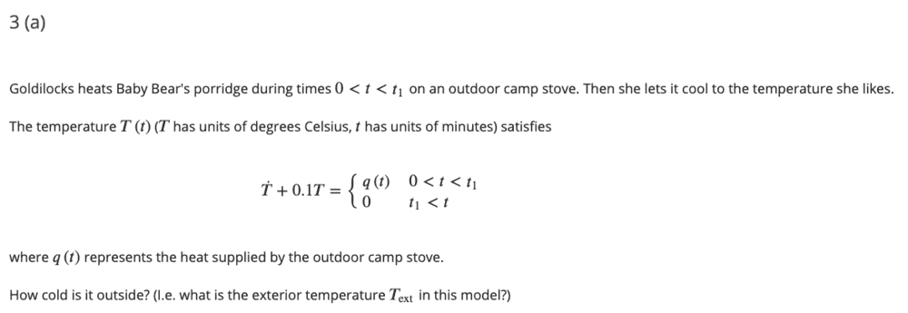

A soup is heated from ##0<t<t_1## on an outdoor camp stove, and is cooled. The temperature ##T(t)## satisfies ##T' + 0.1T = q(t)## when ##0<t<t_1##, and ##T' + 0.1T = 0## when ##t1 < t## where ##q(t)## represents the heat used to warm up the soup. How long will it take for the soup to be at ##40##°C?
##\frac{Dt}{dt} = k(Te - T)##
##T(t) = Te + (T0 - Te)e^{-kt}##
I'm having quite a bit of a problem with this one. I've managed to figure out that ##T_0 = 0##. However, not knowing what ##q(t)## is bothers me, although it seems that I could theoretically solve the problem without knowing it. For ##t>t_1##, integration by parts gives me ##T = Ce^{-t/10}## where ##C = T(t_1)##. And to get ##T(t_1)##, I solve the inhomogeneous equation with ##q(t)##, by letting ##T = ue^{-t/10}##. THen I get that ##u = \int q(t) e^{t/10} dt##. But where do I go from here?

The earlier problem, as far as I can tell, is worded the exactly same way, but I will include it here:

The question (if I googled the right problem) is a little bit different - one is asked to estimate the number of minutes for which the porridge will stay at the optimal temperature of 40°±1° (because Goldilocks won't eat the porridge that is too hot or too cold).
Edit: and there's also a hint that says to use the (differential) equation but not solve it (which is good enough for the estimate).
